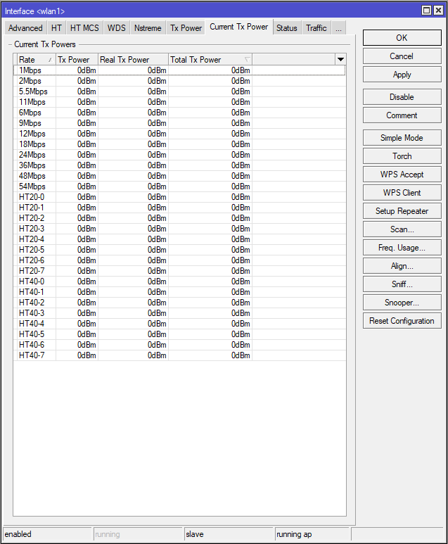

diddie17, I’ve tried to look also, but i didn’t see any figures
under ‘tx power’ both are default
I’ve attached both wlan1 & wlan2 screenshots
why is it like that?
Thank you

I’ve just checked it will be fine, just go with the script and use the default power levels in the script.
