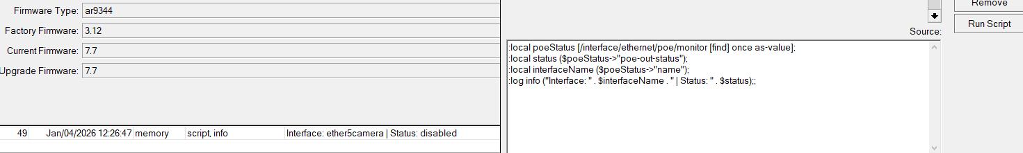

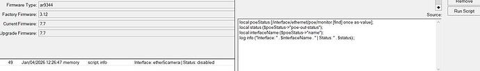

Your code works fine on my RB951Ui-2HnD. Perhaps your interfaces have bad characters in their names. For example, my ether5_camera port prevented the script from working, but the ether5camera port worked.
I am running 7.20.6, if this is another ‘feature’ I might just have to fork my eyes out..
One of the RB’s has “ether5” as the name. I would have thought that should work.
The other had something more complicated which I modified, it didn’t change the outcome.

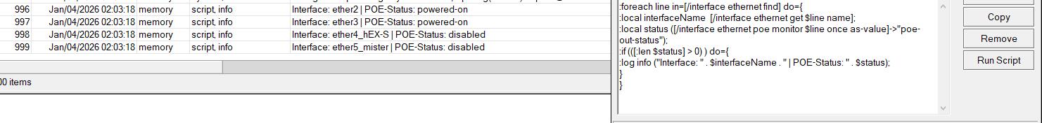

or try this
:foreach line in=[/interface ethernet find] do={
:local interfaceName [/interface ethernet get $line name];
:local status ([/interface ethernet poe monitor $line once as-value]->"poe-out-status");
:if (([:len $status] > 0) and ($status = "powered-on")) do={
:log info ("Interface: " . $interfaceName . " | POE-Status: " . $status);

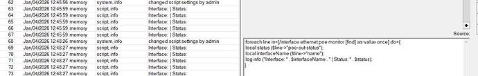

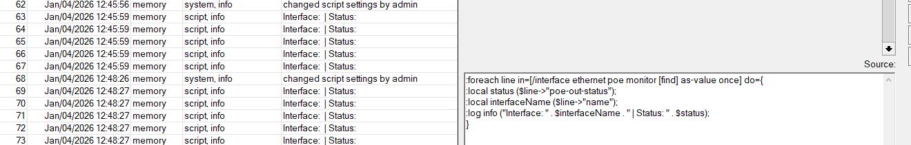

I tried your script but it fails to catch anything, even on the CRS328.

Right, @safelogj good thing I went to bed. I didn’t even spot your snippet was sending the output to the log rather than putting out to console. That is working on all the four devices. Thanks a bunch.
