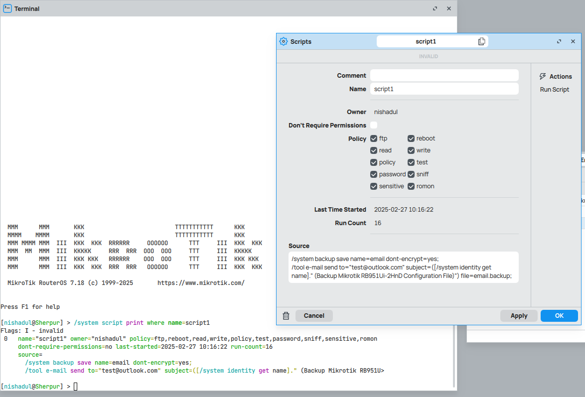

After upgrade ROS my “auto back and sent email” script not working .
my script is:
/system backup save name=email dont-encrypt=yes;
/tool e-mail send to=“test@outlook.com” subject=([/system identity get name]." (Backup Mikrotik RB951Ui-2HnD Configuration File)") file=email.backup;
Log show:
executing script script1 from winbox failed, please check it manually
syntax error (line 2 column 137)
Pl check my script it is working in previous version but not work 7.18 version

I can cut and paste those commands into a cli and they work. Does it work if you do the same and cut and paste from this comment?
Character 137 is the = after file. I wonder if there’s an issue with different quote characters or something.

It’s very hard to tell because you didn’t use a code block, but i think you may have an extra invisible character in there.
Try
/system script print where name=script1
And see if any characters are highlighted in red
[nishadul@Sherpur] > /system script print where name=script1
Flags: I - invalid
0 name=“script1” owner=“nishadul” policy=ftp,reboot,read,write,policy,test,password,sniff,sensitive,romon
dont-require-permissions=no last-started=2025-02-27 10:16:22 run-count=16
source=
/tool e-mail send to=“test@outlook.com” subject=([/system identity get name]." (Backup Mikrotik RB951U>
– [Q quit|D dump|right]
I have write full code in winbox system/script but winbox terminal show few code, not full code
Please note same script worked with ROS 6.49.13, there are no error I think this problem is mikrotik with winbox
My problem is solved after write file name in double quotes, Thank you of all
