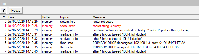

Trying to troubleshoot why one particular mikrotik of mine will not establish a vpn or be able to recieve a request from one, just shows the TCP connection in the log hitting the router. When I checked the logs I noticed "secret string is empty? Its an older rb450g
It is running 6.47
I can only imagine that during startup, the IPsec stack crashes on a configuration (/ip ipsec identity) item which is inconsistent (auth-method=pre-shared-key, but no secret value specified, maybe thanks to some failure during configuration conversion from previous version during upgrade). So check the configuration for existence of such row(s) in /ip ipsec identity; if you find any, fix it (setting the secret to any random string will do for the purpose of dealing with the issue), and reboot the router again.
