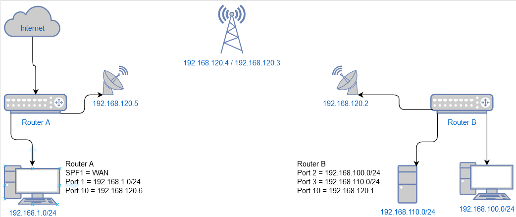

I get my internet access via a radio link to another MT that has it’s own WAN address. Please see attached diagram for network layout. Both routers are RB4011s.
I have a webserver behind router B. It was on the same subnet as the rest of my house, and I had a hairpin on router A which worked fine to provide secure access from both inside and outside the network using my domain name. Because I’m a sucker for punishment / like to tinker, it’s now on a separate subnet, but still behind router B. I would like to be able to access it using it’s domain name from a different subnet behind router B, not the private IP address.
From everything I have read, this would be almost trivial if router B was directly connected to the internet, however…
I can access the server (192.168.110.10) using my domain name from outside my network - ssl cert valid etc. I can also access it from behind router B using the private IP address from 192.168.100.0/24, but obviously then the cert isn’t valid. I understand that this is no longer a hairpin situation - that has been removed from router A. I am hoping that it’s something to do on router B, as that’s at my house. Getting to router A requires a journey - neither router can be manged from the other’s network.
You don’t need hairpin NAT to access server from any other subnet (except from server’s own subnet), including the other subnet off router B. You only need appropriate DNS entries served to computers in subnet 192.168.100.0/24 and appropriate routing (for router A subnets) … If you reconfigure router A so that it knows about subnets 192.168.100.0/24 and 192.168.110.0/24 (being behind 192.168.120.1), you won’t need any of NAT on router B (neither src-nat nor dst-nat).
