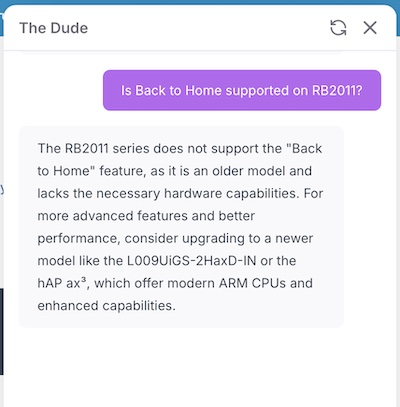

I went to check the docs, but The Dude interrupted me, but he says the RB2011 does not support Back to Home:

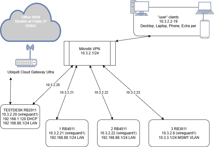

Sorry, I dont really know how to diagram it out what I am trying to do. Will work on trying to diagram things out as I am building them to enhance understanding. Any recommendations on best practices to make diagrams?

Like I said nothing is clear, no diagrams provided.

I have created and successfully connected the peers to the wireguard server. Here is the diagram as it currently is working. However, I am stuck with trying to figure out Allowed Addresses in the peer configurations of WireGuard.
TESTDESK - 10.3.2.1/24; 10.3.2.20/24
vs
1 RB4011 - 10.3.2.1/24; 10.3.2.21/24; 0.0.0.0/0
Removing the 0.0.0.0/0 from TESTDESK did not remove its ability to be on the wireguard network. Am I correct in thinking that the 0.0.0.0/0 Allowed Address is not neccessary if no traffic is expected or desired to go in or out Wireguard other than Winbox? I have the Firewall filter rules to allow input for Wireguard port 51820, and to allow Winbox port 8291 input from Interface List LAN which I added wireguard1 setup correctly I believe, most traffic is not passing through the Wireguard interface.
Unsure of what the 0.0.0.0/0 is actually doing, and if it is just a unneeded addition to the config file that Unifi generated? Also what would be a way of testing this other than just watching the traffic on the interface? Thanks for the help.
Also - wireguard Server is being hosted in the Ubiquiti Cloud Gateway Ultra, forgot to put that in my diagram.
