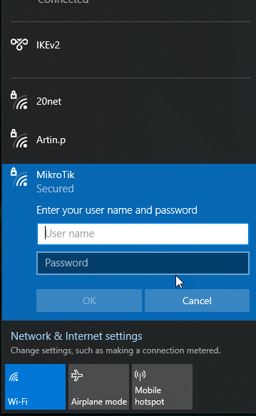

As for the wireless
If you use WPA2 EAP there is no single pre-share key for every user you can create a username password and you can limit the online session to one so no one will give their username and password to anybody else.
I’m just wondering how complicated that is going to
core side
http://forum.mikrotik.com/t/usermanger-on-ros-7-wifi-ent-user-pass/156962/1
client side
easy as any other username and password AUTH
