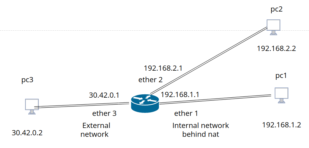

I have a network like this
I want to send udp packets with destination 255.255.255.255 from pc 2 to pc 1 that are not in the same subnet. so the mikrotik router doesn’t forward packets to pc 2. if I bridge interface 1,2 it works. but a bridge is not a good solution. How can I route packets with destination 255.255.255.255 from pc 1 to pc 2 that are not in the same subnet and we don’t want to use the bridge interface.

A zlan device that converts serial to Network is connected to a router that has a protocol to configure it. This device is not like a router that has a key to reset it. Its configuration protocol is based on UDP with destination port 1092 and destination IP 255.255.255.255. When zlan is in the local subnet of a pc it can be configured .I don’t want to configure it from a node with multi hob distance to my zlan. but i want to configure zlan from pc 2 without a bridge interface. Actually it is needed to configure with 255.255.255.255 destination ip when we buy a zlan it can be configured for the first time without need to manually configure it. I mean no matter what is my ip address or zlan ip address it can be configured.
I’v used a zlan Modbus gateway a long time ago but I remember we configured it locally for TCP before deploying it. But if I get it right you want to be able to perform the initial configuration with the device already in place on the other subnet, right?
If you are absolutely sure you don’t want to use bridge filters (ie bridge ip firewall) you might want to try out something like the following dst-nat forwarding rule:
/ip firewall nat add action=dst-nat chain=dstnat in-interface=ether1 dst-address-type=broadcast dst-port=1092 protocol=udp to-addresses=192.168.2.255
Do you know if the device will reply using unicast with the source address or another broadcast? If it uses broadcast, you’ll probably need a matching forwarding rule on the other side as well:
/ip firewall nat add action=dst-nat chain=dstnat in-interface=ether2 dst-address-type=broadcast dst-port=1092 protocol=udp to-addresses=192.168.1.255
