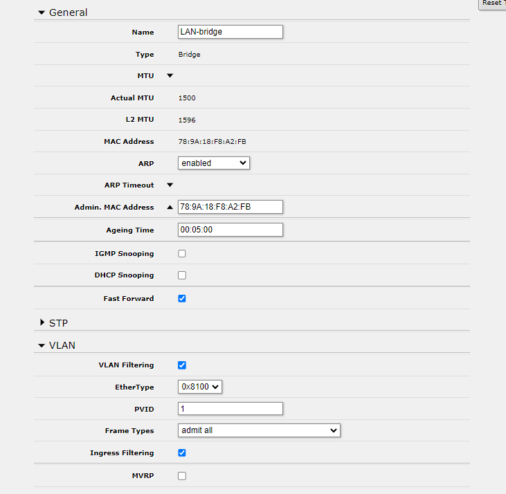

I have an L009 and a CSS610 connected via a trunk port. I cannot access the L009 using WinBox while using connected to the CSS610, but I can access via SSH/HTTPS. My client is located in VLAN 40 on the switch, which I plan to have as my management vlan. I’m assuming this is because I do not have my default vlan setup on the trunk port as its currently set to 1. In order to configure the default vlan to 40, I figured Id change the switch to eth 1 to 40, but where do I configure on the router?
Should I configure the trunk or bridge interface PVID with vlan 40?
Thanks in advance!
It’s the PVID setting.
I sense that your VLAN setup is heading in the wrong direction, so I suggest you to check VLAN setup tutorial. In short: don’t go into “default VLAN over a trunk” hole, configure management VLAN on router properly …
