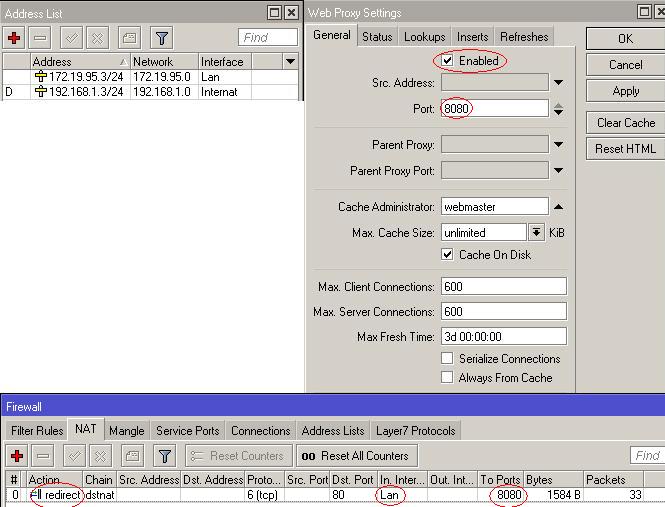

I configed WebProxy And DHCP On Mikrotik And
When I Manually Set Web Proxy Address In My Browser(IE/Firefox), everything Work Correct
Now how Can I Config MikroTik To Set Web Proxy Address In Browser Automatically (Like WPAD On Isa/TMG )?..
What I Must Do In Mikrotik?

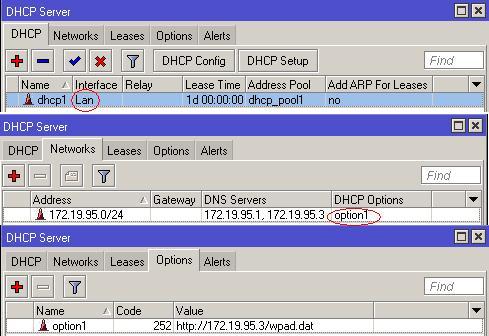

a) WPAD could be set automatically (only in Internet Explorer) from DHCP - you have to add DHCP option, for example:
/ip dhcp-server option
add code=252 name=auto-proxy-config value=http://wpad.intranet/wpad.dat
(where value is address of your wpad script) and then use it in DHCP server network, for example:
add address=192.168.100.0/24 dhcp-option=auto-proxy-config dns-server=192.168.100.1 gateway=192.168.100.1

You can force people to use the proxy with a NAT rule. It only works for HTTP though, it will not work for HTTPS.
add action=redirect chain=dstnat dst-port=80 protocol=tcp
Thanks For Your Answers…But It’s Not Work…
This Is My Config:

4.On Several Forum I Read That DHCP Code for Wpad Is 249 Not 255 (_if This may Help:I Use Licecnce Level 6)?

I have found value of 252 as right value and it is working for me in Internet Explorer. I didn’t try value of 249, but you can try and let me know.

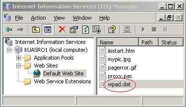

wpad.dat Script File Is Like This:
function FindProxyForURL(url, host)
{ return “PROXY 172.19.95.3:8080 ; DIRECT”; }
I run iis service on my server and add wpad.dat file…

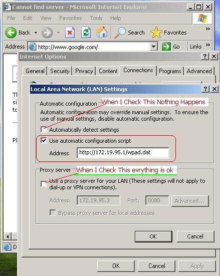

but Even I set Use automutic configuration Script on IE setting nothing Happens…
(172.19.95.1 :My iis server – 172.19.95.3 : my mikrotik )
You have checked option “Use automatic configuration script” and set address - that’s right, but this doesn’t need any DHCP settings, so if this is what you want make to work, forget about DHCP option and the problem is more simple now. (DHCP assignment is applied when you check “Automatically detect settings” only.)
Well, but it is not working for you.. Try to put address “http://172.19.95.1/wpad.dat” to your browser - is it working and displaying script? If it does, that’s good.
Now turn off your browser, turn it on again and try to open any webpage. Check your webserver’s log if file wpad.dat was requested - it should be - web browser will at first ask for WPAD script and after that for webpage.
If the wpad.dat file was requested, then something other is wrong. Maybe you should define content type for wpad.dat as: application/x-ns-proxy-autoconfig - but I don’t know how to do this on IIS.
when i put address “http://172.19.95.1/wpad.dat” in browser I Get “The page cannot be found” Message
but Something Interest…

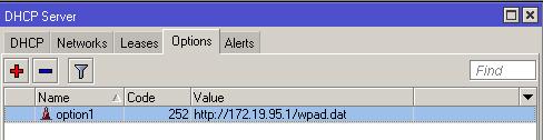

when I change Wpad File Extension To .txt/.doc/.htm/.js And also set Use automatic configuration Script on IE setting It Working…
but even I change File Extension on dhcp option and then select automatically detect setting on IE, it’s not work…
Any Idea…
Check your webserver settings - the WPAD file must be accessible.
So http://172.19.95.1/wpad.txt is working in browser as well? It seems that you have some rule that denies access to .dat files.
Well, this is another problem. To apply DHCP setting it is necessary to renew address (in windows: ipconfig -release & ipconfig -renew) or restart computer. Also check in web server’s log if the file is requested - it should be.
