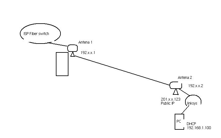

I have 2 antenas one at 2 kilometers from my house and the other one is on my house, I wwhant to use my internet conection from Point A to B
My ISP have a fiber conection that ends on a switch so i conect the antena to one port and on the other site ( my house) I have the other antena and is conected to the wan port of my linksys… but I am not able to use the internet… Why?
my setup
AP (2kms)
IP 192.10.10.1
WDS =Enable
Nstream= enable
for both antenas there is a brige wlan1 and ether1 and the conection between antenas is ok
Antena Client (my house)
IP 192.168.10.2
WDS=enable
Nstream= Enable
now to conect to the internet I set the IP gived by the ISP on the linksys
201.x.x.123 IP Gateway 201.x.x.122 mask 255.x.x.248 If I conect the linksys directly to the switch that is on point 1 I can navigate to the internet, but in point 2 (my house) I cant navigate.. I am unable to ping tha isp address but i can ping the antenas
I think I am loose on somewhere… so I need a little help here.
Note, that mode=station could not be bridged. You need to use WDS to create transparent link over wireless,
http://wiki.mikrotik.com/wiki/Transparently_Bridge_two_Networks
use mode=station-wds on the second end, when Nstreme is enabled.
note that this only works if the destination has wds enabled; if not insetad of bridging you need to set up masquarede.
Thanks now is working very well
thaks for you help guys
