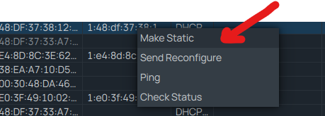

Using WinBox you have to select one or more entries, right button and then select "Make static"

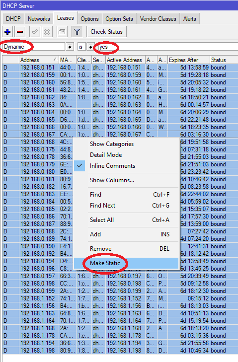

Yeah, but with 100 entries that can be a bit tedious...
Why?
The user use web interface on one UNDEFINED version, not winbox, but on winbox........
Not too much If they all have addresses form particular IP pool.
Hence:
