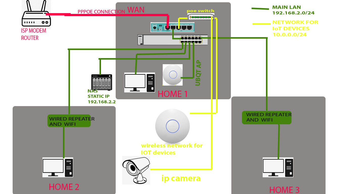

Hello.I am currently in the need of help setting up my home network.
First of all i have basic knowledge of networking and and im finding kinda of difficult familiarizing with RouterOS.My building consists of 3 houses and one main internet connection. Basicaly my previous setup Was just the ISP’s modem/router/ap handling 5 pc’s,6 phones,smart tvs ,etc.And i had a number of problems with either wifi or the router needing to be restarted or ping spikes while gaming the usual problems.Since my building is renovating i had the chance to basically wire all 3 homes to my closet and build a small network rack with a patch panel/ 16 port switch/Mikrotik RB750Gr3/and also another 8 port poe swithc for my cameras /Below i designed a diagram to help you understand my setup.
So Basically everything is setup and wired all thats left is for my mikrotik to be setup’ed propertly.
I have established a ppoe client on my MT from my ISP’s router on ether1/wan . I created NAT to for pppoe to allow internet.I Created a new ip address 192.168.2.0/24 .I Bridged Ether2-5 on bridge1.
I gave the 192.168.2.0 to bridge1 and created DHCP server on bridge1 to hand out ip’s from 192.168.2.15-192.168.2.254.Everything kinda works but i need a more advanced config becouse i want to isolate my IoT devices such as smart switches smart bubls etc and also use that network for my cctv system.I think the best way to do that is to create VLAN on ether 3 but althought i researched a lot i kind of fell short.So i would like to ask how can i create a Vlan on ether3 that i can administer from my main computer and maybe controll the devices without chaning wifi but also those devices cant access my main netwrok? Is that possible?Basically i want to acces devices on vlan300 but i dont want devices to acces my main network.I also have many more questions but i kinda wanna solve this matter so everything is setup propertly,

ether1 ← ISP
ether2 → IoT → 8 port PoE switch → all IoT device, powered by PoE or not
ether3 → home 1 - > 16 port switch
ether4 → home 2
ether5 → home 3
do not use any form of bridge
DHCP of things → ether2
DHCP house 1 → ether3
DHCP house 2 → ether4
DHCP house 3 → ether5

so for now i have this.I did not use vlans.Basically i want 2 seperated networks ,Main and Iot network .I want all 3 house to comunicate with each other mainly couse of my freenas/plex so. I created a bridge for ether2-3 called MainBridge with ip 192.168.2.1/24 and Iot bridge on ether4-5 with 10.0.0.1/24 . Both have aprpopriete dhcp servers.
So to test i connect 2 laptops.One on ether 2 and the other on ether 5.laptop 1 got 192.168.2.254 and the other 10.0.0.254.All good. BUT i could ping each other meaning networks were comunicating.So i added firewall rule as you said so MainBridge drops any connections attempt from Iotbridge but not vice versa.So i can ping laptop 2 from laptop 1 but not the other way around.I think that is what was looking isnt it.Am i missing something?

Basically i have Main Bridge(eth2-3) and Iot bridge(eth4-5).each have their own ip address.
If i remember correctly for iot bridge to only have wan acces but not lan access i simply adde 1 firewall filter.
Chain-Output Out inteface IotBridge action-block
after that laptop 2 connected to iot bridge could not reach gateway nor ping laptop 1 but laptop one could ping laptop 2.
Im experimenting i dont think this is the final config by any means,router os has many capabilites but for a novice like me its really hard to accomplish even the simple things!! Anyway ill post my config asap!

So maybe you can advice me with a proper setup ?
All I want is basic security from internet
Ether1 is pppoe isp
ether2 main network
Ether5 guest/iot network
I want ether 5 to be isolated kinda but I want to have to it from main network
That’s all if you can post the correct firewall rules I’ll be grateful

@zedoxx: what I’d do is the following:
  1. reset to default config
  2. use quickset to configure WAN … PPPoE
  3. go into “normal” GUI and mnever ever go back to quickset unless you repeat config from step #1
  4. remove ether5 from bridge
  5. add IP address to ether5. Configure additional address pool and DHCP server on ether5
  6. add a firewall filter rule which blocks connections originating from ether5 and targeting LAN:
filter add chain=forward action=drop comment="block connections from IoT/guest to LAN" connection-state=new in-interface=ether5 out-interface-list=LAN
Move it to pennultimate place in chain=forward which should be just below this rule:
filter add chain=forward action=drop connection-state=invalid comment="defconf: drop invalid"
When executing step #4 be sure you connect via interface other than ether5.
Thats it in a nutshell, LOL.
