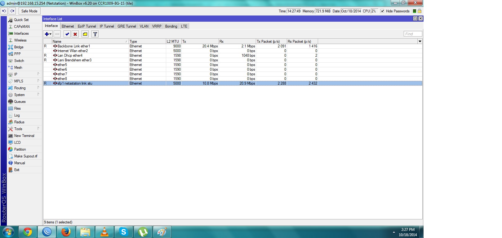

hi i have the RB ccr1009-8G-1S but since i mountet the sfp on my router & let it full-dublex with 1000 base link ok . the sfp generates false upload trafik
