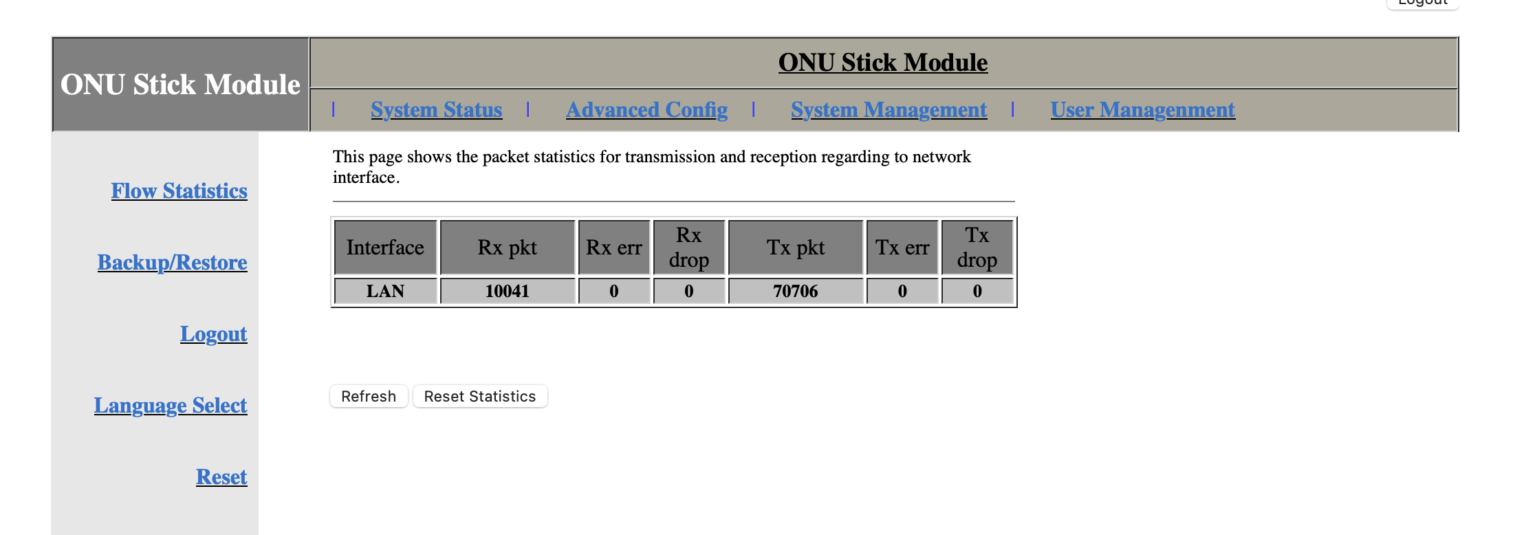

After that i can input in browser http://192.168.1.1/ (in my case) and using standard login&password (in my case, from git) - see web-ui and use telnet from my PC.
Thank you for detailed info!
For finally I got there!
But I just can’t find any tools to upgrade firmware in WebUI
Current version is Firmware Version V1.9.0-191015

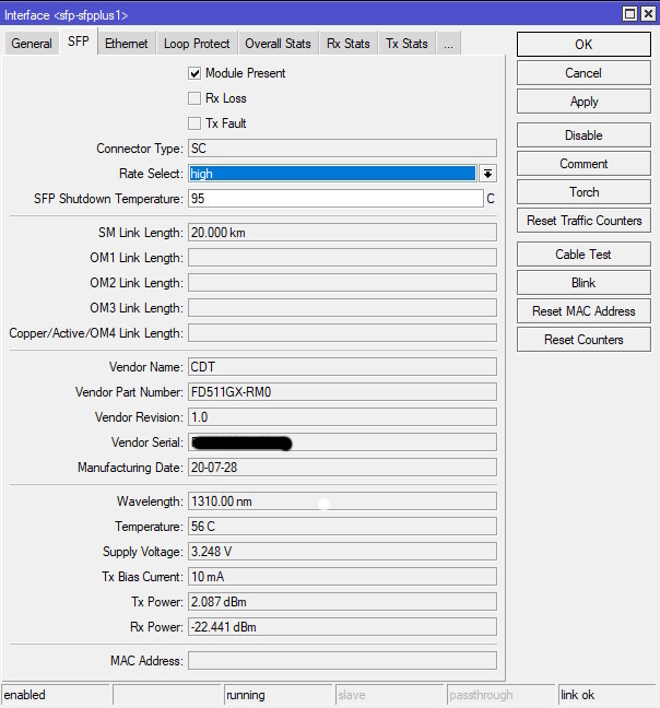

Happy to say, that Mikrotik in new stable 7.14.1 (technically in 7.14) added
single byte I2c read transactions
That solved “bad eeprom” sign.
Now it reads my SFP module FD511GX-RM0 and shows it’s data in info window!
Thank you, Mikrotik Team!
