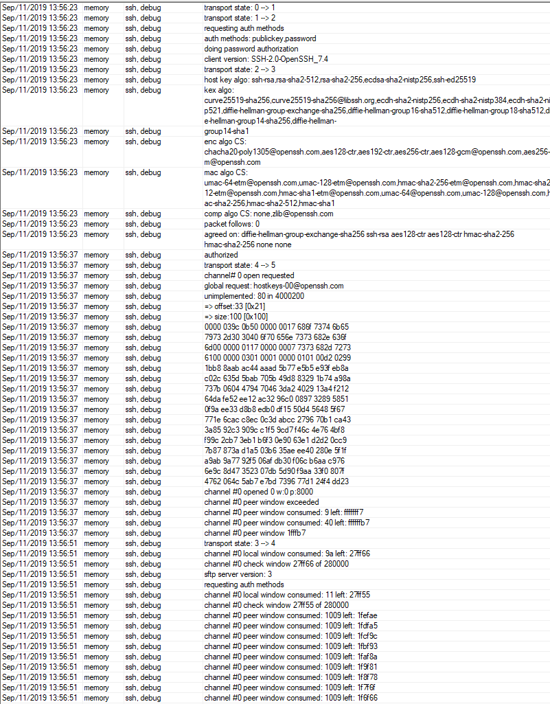

Try this for verbose logging:
/system logging add topic=ssh,!packet

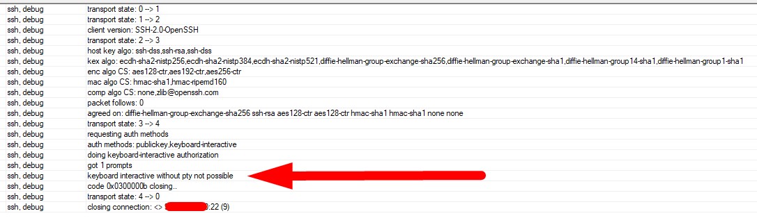

14:54:19 ssh,debug transport state: 0 → 1
14:54:19 ssh,debug transport state: 1 → 2
14:54:19 ssh,debug client version: SSH-2.0-OpenSSH
14:54:19 ssh,debug transport state: 2 → 3
14:54:19 ssh,debug host key algo: ssh-dss,ssh-rsa,ssh-dss
14:54:19 ssh,debug kex algo: ecdh-sha2-nistp256,ecdh-sha2-nistp384,ecdh-sha2-nistp521,diffie-hellman-group-exchange-sha256,diffie-hellman-group-exchange-sha1,diffie-hellman-group14-sha1,diffie-hellman-group1-sha1
14:54:19 ssh,debug enc algo CS: aes128-ctr,aes192-ctr,aes256-ctr
14:54:19 ssh,debug mac algo CS: hmac-sha1,hmac-ripemd160
14:54:19 ssh,debug comp algo CS: none,> zlib@openssh.com >
14:54:19 ssh,debug packet follows: 0
14:54:19 ssh,debug agreed on: diffie-hellman-group-exchange-sha256 ssh-rsa aes128-ctr aes128-ctr hmac-sha1 hmac-sha1 none none
14:54:21 ssh,debug transport state: 3 → 4
14:54:21 ssh,debug requesting auth methods
14:54:21 ssh,debug auth methods: publickey,keyboard-interactive
14:54:21 ssh,debug doing keyboard-interactive authorization
14:54:22 ssh,debug got 1 prompts
14:54:22 ssh,debug > keyboard interactive without pty not possible
14:54:22 ssh,debug code 0x0300000b closing..
14:54:22 ssh,debug transport state: 4 → 0
14:54:22 ssh,debug closing connection: <> xx.xx.xx.xx:22 (9)
As posted in third post in this thread… RouterOS is picky about authentication methods.
Can you configure SSH server to disable all but password authentication? Follow the link above for details.

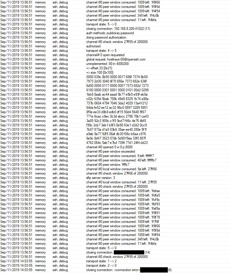

maybe is picky, but same ROS on arm platform (RB1100) working flawlessly, CRS328 failed with log below
The device from last log successfully authorized, so looks like different issue.
