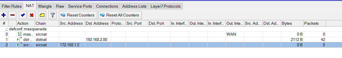

Now sinumerik acts on outside same as a plc so I have at the moment improvised setup with s7-1200 plc to which I can connect directly with mentioned IP 172.30.1.2 but after putting mikrotik in between it stops working.
And yes, I did change IP settings of Kepware to try to get to 192.168.2.80 now and yes I changed IP settings of my LAN card.
I need to do the following:
Link public 192.168.2.80 on port 1 WAN to internal IP 172.30.1.2 which is connected to bridge on port 2.
I have RB760iGS. I am using default configuration.
From default configuration I have changed:
  • Removed DHCP Client on WAN port.
  • Added IP address 192.168.2.80 to the WAN port
  • Changed IP on bridge to 172.30.1.5
  • Disabled DHCP server on Bridge
I did:
/ip firewall nat add chain=dstnat dst-address=192.168.2.80 action=dst-nat
to-addresses=172.30.1.2
/ip firewall nat add chain=srcnat src-address=172.30.1.2 action=src-nat
to-addresses=192.168.2.80
I do not need any firewall or protection at all as it is part of internal network, which has no access to the internet.
Would I have to delete any of the firewall rules?
From pictures in attachments, you can see I get packets on Nat-DST, those packets I get when I start the Kepware server
And the second picture is from filter rules and it does not seem like anything would be rejected.
in attachments is also export of configuration.
bck.rsc (3.02 KB)
Does the PLC device know to use 172.30.1.5 as default gateway (or at least for specific subnet where KEpware host resides)? If not, then you’ll have to add src-nat for KEpware traffic:
add action=masquerade chain=srcnat dst-address=172.30.1.2
so that packets will appear to originate from mikrotik to PLC device.
BTW, the src-nat rule you have does only work for connections originally initiated by PLC device and probably does nothing in redard to KEpware connectivity.
BTW2: you will eventually want to narrow down the dst-nat rule only to map needed protocols and ports … you’ll have to find out which ports the PLC devices uses for incoming connections and only port forward those. As the rule stands now, it forwards just everything (including e.g. winbox over IP connections), not sure you want to have it this way.
Thank you, your suggestion worked.
