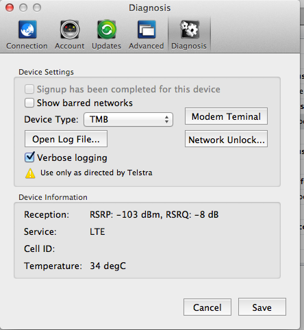

Which would indicate some sort of sim issue. Interestingly when I plugged it in to my laptop and used the telstra application to connect it came back with “account needs to be activated”. Tried to activate it and didn’t work. Rang telstra they said, you need to go in to diag mode in the app and set the device type to TMB (see screenshot). It is set to pre-paid by default and this is a business account. So I’m just wondering if this has something to do with stopping it at the command above.
I’ve got full logs from the telstra app below in case its useful for anyone who knows anything about AT commands and can see what might be causing the problem.
first up is the log from connecting with pre-paid mode (ie getting the need to activate issue). Below that is the connection in TMB mode.
any assistance is greatly appreciated

2013-10-31 11:01:48.053 Mobile Broadband Manager[873:13b4b] Received 28 bytes: PRLREGION 0x03
2013-10-31 11:01:48.054 Mobile Broadband Manager[873:13b4b] Received 30 bytes: PCSCDISABLE 0x03
2013-10-31 11:01:48.054 Mobile Broadband Manager[873:13b4b] Received 33 bytes: AUTONETWORKMODE 0x02
2013-10-31 11:01:48.054 Mobile Broadband Manager[873:13b4b] Received 29 bytes: SWOCENABLE 0x03
2013-10-31 11:01:48.054 Mobile Broadband Manager[873:13b4b] Received 25 bytes: HSICON 0x01
2013-10-31 11:01:48.054 Mobile Broadband Manager[873:13b4b] Received 30 bytes: USBMSENABLE 0x01
2013-10-31 11:01:48.055 Mobile Broadband Manager[873:13b4b] Received 33 bytes: SINGLEAPNSWITCH 0x01
2013-10-31 11:01:48.055 Mobile Broadband Manager[873:13b4b] Received 25 bytes: LTESMS 0x01
2013-10-31 11:01:48.055 Mobile Broadband Manager[873:13b4b] Received 3 bytes: OK
2013-10-31 11:01:48.143 Mobile Broadband Manager[873:1c21f] Sent 10 bytes: AT+CGREG?
2013-10-31 11:01:48.148 Mobile Broadband Manager[873:13b4b] Received 10 bytes: AT+CGREG?
2013-10-31 11:01:48.148 Mobile Broadband Manager[873:13b4b] Received 12 bytes: +CGREG: 1,1
2013-10-31 11:01:48.148 Mobile Broadband Manager[873:13b4b] Received 3 bytes: OK
2013-10-31 11:01:48.244 Mobile Broadband Manager[873:1c21f] Sent 12 bytes: AT+COPS=3,0
2013-10-31 11:01:48.246 Mobile Broadband Manager[873:13b4b] Received 12 bytes: AT+COPS=3,0
2013-10-31 11:01:48.248 Mobile Broadband Manager[873:13b4b] Received 3 bytes: OK
2013-10-31 11:01:49.153 Mobile Broadband Manager[873:1c21f] Sent 9 bytes: AT+COPS?
2013-10-31 11:01:49.155 Mobile Broadband Manager[873:13b4b] Received 9 bytes: AT+COPS?
2013-10-31 11:01:49.156 Mobile Broadband Manager[873:13b4b] Received 23 bytes: +COPS: 1,0,“Telstra”,7
2013-10-31 11:01:49.156 Mobile Broadband Manager[873:13b4b] Received 3 bytes: OK
2013-10-31 11:01:50.162 Mobile Broadband Manager[873:1c21f] Sent 12 bytes: AT+COPS=3,2
2013-10-31 11:01:50.171 Mobile Broadband Manager[873:13b4b] Received 12 bytes: AT+COPS=3,2
2013-10-31 11:01:50.171 Mobile Broadband Manager[873:13b4b] Received 3 bytes: OK
2013-10-31 11:01:51.171 Mobile Broadband Manager[873:1c21f] Sent 9 bytes: AT+COPS?
2013-10-31 11:01:51.173 Mobile Broadband Manager[873:13b4b] Received 9 bytes: AT+COPS?
2013-10-31 11:01:51.174 Mobile Broadband Manager[873:13b4b] Received 21 bytes: +COPS: 1,2,“50501”,7
2013-10-31 11:01:51.174 Mobile Broadband Manager[873:13b4b] Registered on network
2013-10-31 11:01:51.174 Mobile Broadband Manager[873:13b4b] Interface name is en7
2013-10-31 11:01:55.821 Mobile Broadband Manager[873:19a0b] IPv4 active
2013-10-31 11:01:55.821 Mobile Broadband Manager[873:13013] IPv4 active
2013-10-31 11:01:55.821 Mobile Broadband Manager[873:10d03] IPv4 active
2013-10-31 11:01:55.821 Mobile Broadband Manager[873:aeab] IPv4 active
2013-10-31 11:01:55.821 Mobile Broadband Manager[873:f103] IPv4 active
2013-10-31 11:01:56.177 Mobile Broadband Manager[873:13b4b] Not connected
2013-10-31 11:01:56.226 Mobile Broadband Manager[873:13b4b] New status: Not connected
2013-10-31 11:01:56.290 Mobile Broadband Manager[873:13b4b] showAssistMeView: The Pre-Paid service has not been activated
2013-10-31 11:01:56.309 Mobile Broadband Manager[873:13b4b] Removing assist me view
2013-10-31 11:01:56.310 Mobile Broadband Manager[873:13b4b] About to verify IMEI
2013-10-31 11:01:56.311 Mobile Broadband Manager[873:13b4b] Modem is not registered (activated).
2013-10-31 11:01:56.311 Mobile Broadband Manager[873:1003] Stopping the view animation
2013-10-31 11:01:56.312 Mobile Broadband Manager[873:13b4b] showAssistMeView: The Pre-Paid service has not been activated
2013-10-31 11:01:56.326 Mobile Broadband Manager[873:13b4b] Received 3 bytes: OK
2013-10-31 11:01:56.327 Mobile Broadband Manager[873:1003] Stopping the view animation
2013-10-31 11:01:56.417 Mobile Broadband Manager[873:1c21f] Sent 9 bytes: AT+RSCP?
2013-10-31 11:01:56.426 Mobile Broadband Manager[873:13b4b] Received 9 bytes: AT+RSCP?
2013-10-31 11:01:56.426 Mobile Broadband Manager[873:13b4b] Received 8 bytes: +RSCP:
2013-10-31 11:01:56.426 Mobile Broadband Manager[873:13b4b] Received 15 bytes: Car0 RSCP: 0
2013-10-31 11:01:56.427 Mobile Broadband Manager[873:13b4b] Received 16 bytes: Car1 RSCP: n/a
2013-10-31 11:01:56.427 Mobile Broadband Manager[873:13b4b] Received 3 bytes: OK
2013-10-31 11:01:56.519 Mobile Broadband Manager[873:1c21f] Sent 11 bytes: AT!PCTEMP?
2013-10-31 11:01:56.524 Mobile Broadband Manager[873:13b4b] Received 11 bytes: AT!PCTEMP?
2013-10-31 11:01:56.524 Mobile Broadband Manager[873:13b4b] Received 19 bytes: Temp state: Normal
2013-10-31 11:01:56.525 Mobile Broadband Manager[873:13b4b] Received 21 bytes: Temperature: 35 degC
2013-10-31 11:01:56.525 Mobile Broadband Manager[873:13b4b] Received 3 bytes: OK
2013-10-31 11:01:56.621 Mobile Broadband Manager[873:1c21f] Sent 10 bytes: ATCNTI=0
2013-10-31 11:01:56.629 Mobile Broadband Manager[873:13b4b] Received 10 bytes: AT
CNTI=0
2013-10-31 11:01:56.629 Mobile Broadband Manager[873:13b4b] Received 13 bytes: CNTI: 0,LTE
2013-10-31 11:01:56.631 Mobile Broadband Manager[873:13b4b] Received 3 bytes: OK
2013-10-31 11:01:57.228 Mobile Broadband Manager[873:1c21f] Sent 12 bytes: AT+COPS=3,0
2013-10-31 11:01:57.229 Mobile Broadband Manager[873:13b4b] Received 12 bytes: AT+COPS=3,0
2013-10-31 11:01:57.230 Mobile Broadband Manager[873:13b4b] Received 3 bytes: OK
2013-10-31 11:01:58.238 Mobile Broadband Manager[873:1c21f] Sent 9 bytes: AT+COPS?
2013-10-31 11:01:58.239 Mobile Broadband Manager[873:13b4b] Received 9 bytes: AT+COPS?
2013-10-31 11:01:58.240 Mobile Broadband Manager[873:13b4b] Received 23 bytes: +COPS: 1,0,“Telstra”,7
2013-10-31 11:01:58.240 Mobile Broadband Manager[873:13b4b] Received 3 bytes: OK
2013-10-31 11:01:59.248 Mobile Broadband Manager[873:1c21f] Sent 12 bytes: AT+COPS=3,2
2013-10-31 11:01:59.251 Mobile Broadband Manager[873:13b4b] Received 12 bytes: AT+COPS=3,2
2013-10-31 11:01:59.251 Mobile Broadband Manager[873:13b4b] Received 3 bytes: OK
2013-10-31 11:02:00.259 Mobile Broadband Manager[873:1c21f] Sent 9 bytes: AT+COPS?
2013-10-31 11:02:00.268 Mobile Broadband Manager[873:13b4b] Received 9 bytes: AT+COPS?
2013-10-31 11:02:00.268 Mobile Broadband Manager[873:13b4b] Received 21 bytes: +COPS: 1,2,“50501”,7
2013-10-31 11:02:00.268 Mobile Broadband Manager[873:13b4b] Received 3 bytes: OK
2013-10-31 11:02:00.628 Mobile Broadband Manager[873:1003] Received termination event for: IOUSBDevice
2013-10-31 11:02:00.629 Mobile Broadband Manager[873:1003] Modem removed
Connection in TMB mode
2013-10-31 11:06:21.366 Mobile Broadband Manager[873:10d03] IPv6 active
2013-10-31 11:06:21.366 Mobile Broadband Manager[873:aeab] IPv6 active
2013-10-31 11:06:21.366 Mobile Broadband Manager[873:13013] IPv6 active
2013-10-31 11:06:21.367 Mobile Broadband Manager[873:f103] IPv6 active
2013-10-31 11:06:21.366 Mobile Broadband Manager[873:19a0b] IPv6 active
2013-10-31 11:06:22.590 Mobile Broadband Manager[873:1003] Modem Model <SierraSWOCModel: 0x8678ba0>
2013-10-31 11:06:22.594 Mobile Broadband Manager[873:1003] Modem address <SierraSWOCModel: 0x8678ba0>
2013-10-31 11:06:22.602 Mobile Broadband Manager[873:1003] New status: No Next G™ device
2013-10-31 11:06:22.602 Mobile Broadband Manager[873:1003] Destroying modem object <NoModem: 0x8b9b520>
2013-10-31 11:06:22.602 Mobile Broadband Manager[873:1003] Modem started
2013-10-31 11:06:22.607 Mobile Broadband Manager[873:1003] Received termination event for: IOUSBDevice
2013-10-31 11:06:22.607 Mobile Broadband Manager[873:1003] Modem removed
2013-10-31 11:06:22.607 Mobile Broadband Manager[873:1003] showAssistMeView: Unable to detect your Mobile Broadband device
2013-10-31 11:06:22.611 Mobile Broadband Manager[873:1003] Creating modemModel <NoModem: 0xc558ef0>
2013-10-31 11:06:22.611 Mobile Broadband Manager[873:1003] Modem Model <NoModem: 0xc558ef0>
2013-10-31 11:06:22.612 Mobile Broadband Manager[873:1003] Modem address <NoModem: 0xc558ef0>
2013-10-31 11:06:22.619 Mobile Broadband Manager[873:1003] Modem disappeared
2013-10-31 11:06:22.619 Mobile Broadband Manager[873:1003] Stopping the view animation
2013-10-31 11:06:22.620 Mobile Broadband Manager[873:1003] New status: No Next G™ device
2013-10-31 11:06:22.623 Mobile Broadband Manager[873:1003] Stopping the view animation
2013-10-31 11:06:22.632 Mobile Broadband Manager[873:1003] Received arrival event for: IOUSBDevice
2013-10-31 11:06:22.632 Mobile Broadband Manager[873:1003] Creating modemModel <SierraAC320U: 0x22b7420>
2013-10-31 11:06:22.632 Mobile Broadband Manager[873:1003] New status: No Next G™ device
2013-10-31 11:06:22.634 Mobile Broadband Manager[873:1003] Found Ethernet Interface:en7
2013-10-31 11:06:22.635 Mobile Broadband Manager[873:1003] Modem Model <SierraAC320U: 0x22b7420>
2013-10-31 11:06:22.636 Mobile Broadband Manager[873:1003] Modem address <SierraAC320U: 0x22b7420>
2013-10-31 11:06:22.653 Mobile Broadband Manager[873:1003] Removing assist me view
2013-10-31 11:06:22.654 Mobile Broadband Manager[873:1003] New status: Initialising…
2013-10-31 11:06:22.654 Mobile Broadband Manager[873:1003] Device already open, closing
2013-10-31 11:06:22.654 Mobile Broadband Manager[873:1003] Error waiting for drain - Device not configured(6).
2013-10-31 11:06:22.654 Mobile Broadband Manager[873:1003] Error resetting tty attributes - Device not configured(6).
2013-10-31 11:06:22.655 Mobile Broadband Manager[873:1003] device closed
2013-10-31 11:06:22.658 Mobile Broadband Manager[873:1003] Modem started
2013-10-31 11:06:22.659 Mobile Broadband Manager[873:1003] Stopping the view animation
2013-10-31 11:06:22.735 Mobile Broadband Manager[873:1c233] Sent 7 bytes: ATE1V1
2013-10-31 11:06:22.744 Mobile Broadband Manager[873:1e903] Received 7 bytes: ATE1V1
2013-10-31 11:06:22.757 Mobile Broadband Manager[873:1e903] Received 3 bytes: OK
2013-10-31 11:06:23.165 Mobile Broadband Manager[873:19a0b] IPv6 active
2013-10-31 11:06:23.165 Mobile Broadband Manager[873:10d03] IPv6 active
2013-10-31 11:06:23.166 Mobile Broadband Manager[873:13013] IPv6 active
2013-10-31 11:06:23.166 Mobile Broadband Manager[873:f103] IPv6 active
2013-10-31 11:06:23.166 Mobile Broadband Manager[873:aeab] IPv6 active
2013-10-31 11:06:24.755 Mobile Broadband Manager[873:1c233] Sent 10 bytes: AT+CMEE=2
2013-10-31 11:06:24.764 Mobile Broadband Manager[873:1e903] Received 10 bytes: AT+CMEE=2
2013-10-31 11:06:24.764 Mobile Broadband Manager[873:1e903] Received 3 bytes: OK
2013-10-31 11:06:24.856 Mobile Broadband Manager[873:1c233] Sent 4 bytes: ATI
2013-10-31 11:06:24.859 Mobile Broadband Manager[873:1e903] Received 4 bytes: ATI
2013-10-31 11:06:24.862 Mobile Broadband Manager[873:1e903] Received 44 bytes: Manufacturer: Sierra Wireless, Incorporated
2013-10-31 11:06:24.863 Mobile Broadband Manager[873:1e903] Received 20 bytes: Model: AirCard 320U
2013-10-31 11:06:24.863 Mobile Broadband Manager[873:1e903] Received 74 bytes: Revision: SWI9200X_03.05.23.09ap r5836 carmd-en-10527 2013/06/17 18:01:23
2013-10-31 11:06:24.864 Mobile Broadband Manager[873:1e903] Received 22 bytes: IMEI: 357272045321415
2013-10-31 11:06:24.865 Mobile Broadband Manager[873:1e903] helpMenuItem is not removed
2013-10-31 11:06:24.867 Mobile Broadband Manager[873:1e903] Received 12 bytes: IMEI SV: 17
2013-10-31 11:06:24.868 Mobile Broadband Manager[873:1e903] Received 19 bytes: FSN: CC42393175110
2013-10-31 11:06:24.868 Mobile Broadband Manager[873:1e903] Received 15 bytes: 3GPP Release 8
2013-10-31 11:06:24.868 Mobile Broadband Manager[873:1e903] Received 13 bytes: +GCAP: +CGSM
2013-10-31 11:06:24.868 Mobile Broadband Manager[873:1e903] Received 3 bytes: OK
2013-10-31 11:06:24.958 Mobile Broadband Manager[873:1c233] Sent 9 bytes: AT+CFUN?
2013-10-31 11:06:24.963 Mobile Broadband Manager[873:1e903] Received 9 bytes: AT+CFUN?
2013-10-31 11:06:24.963 Mobile Broadband Manager[873:1e903] Received 9 bytes: +CFUN: 1
2013-10-31 11:06:26.965 Mobile Broadband Manager[873:1e903] Received 3 bytes: OK
2013-10-31 11:06:26.976 Mobile Broadband Manager[873:1c233] Sent 9 bytes: AT!BAND?
2013-10-31 11:06:26.979 Mobile Broadband Manager[873:1e903] Received 9 bytes: AT!BAND?
2013-10-31 11:06:26.982 Mobile Broadband Manager[873:1e903] Received 12 bytes: Index, Name
2013-10-31 11:06:27.595 Mobile Broadband Manager[873:1da13] Destroying modem object <SierraSWOCModel: 0x8678ba0>
2013-10-31 11:06:27.614 Mobile Broadband Manager[873:1df23] Destroying modem object <NoModem: 0xc558ef0>
2013-10-31 11:06:27.658 Mobile Broadband Manager[873:1e407] Installed driver:1.1.5 loaded driver:1.1.5
2013-10-31 11:06:27.984 Mobile Broadband Manager[873:1e903] Received 14 bytes: 00, All Bands
2013-10-31 11:06:27.984 Mobile Broadband Manager[873:1e903] Received 3 bytes: OK
2013-10-31 11:06:27.986 Mobile Broadband Manager[873:1c233] Sent 10 bytes: AT!BAND=0
2013-10-31 11:06:27.988 Mobile Broadband Manager[873:1e903] Received 10 bytes: AT!BAND=0
2013-10-31 11:06:28.002 Mobile Broadband Manager[873:1e903] Received 3 bytes: OK
2013-10-31 11:06:28.088 Mobile Broadband Manager[873:1c233] Sent 9 bytes: AT+CPIN?
2013-10-31 11:06:28.095 Mobile Broadband Manager[873:1e903] Received 9 bytes: AT+CPIN?
2013-10-31 11:06:28.095 Mobile Broadband Manager[873:1e903] Received 13 bytes: +CPIN: READY
2013-10-31 11:06:28.096 Mobile Broadband Manager[873:1e903] Sim ready
2013-10-31 11:06:28.096 Mobile Broadband Manager[873:1e903] Received 3 bytes: OK
2013-10-31 11:06:28.189 Mobile Broadband Manager[873:1c233] Sent 8 bytes: AT+CIMI
2013-10-31 11:06:28.191 Mobile Broadband Manager[873:1e903] Received 8 bytes: AT+CIMI
2013-10-31 11:06:28.371 Mobile Broadband Manager[873:1e903] Received 16 bytes: 505013450672114
2013-10-31 11:06:28.371 Mobile Broadband Manager[873:1e903] Received 3 bytes: OK
2013-10-31 11:06:28.391 Mobile Broadband Manager[873:1c233] Sent 15 bytes: AT+CLCK=“SC”,2
2013-10-31 11:06:28.395 Mobile Broadband Manager[873:1e903] Received 15 bytes: AT+CLCK=“SC”,2
2013-10-31 11:06:28.539 Mobile Broadband Manager[873:1e903] Received 9 bytes: +CLCK: 0
2013-10-31 11:06:28.539 Mobile Broadband Manager[873:1e903] Received 3 bytes: OK
2013-10-31 11:06:28.594 Mobile Broadband Manager[873:1c233] Sent 10 bytes: AT+CPINC?
2013-10-31 11:06:28.600 Mobile Broadband Manager[873:1e903] Received 10 bytes: AT+CPINC?
2013-10-31 11:06:28.640 Mobile Broadband Manager[873:1e903] Received 18 bytes: +CPINC: 3,3,10,10
2013-10-31 11:06:28.641 Mobile Broadband Manager[873:1e903] Received 3 bytes: OK
2013-10-31 11:06:28.695 Mobile Broadband Manager[873:1c233] Sent 9 bytes: AT+CREG?
2013-10-31 11:06:28.697 Mobile Broadband Manager[873:1e903] Received 9 bytes: AT+CREG?
2013-10-31 11:06:28.697 Mobile Broadband Manager[873:1e903] Received 11 bytes: +CREG: 0,1
2013-10-31 11:06:28.697 Mobile Broadband Manager[873:1e903] Received 3 bytes: OK
2013-10-31 11:06:28.796 Mobile Broadband Manager[873:1c233] Sent 10 bytes: AT+CREG=2
2013-10-31 11:06:28.803 Mobile Broadband Manager[873:1e903] Received 10 bytes: AT+CREG=2
2013-10-31 11:06:28.803 Mobile Broadband Manager[873:1e903] Received 3 bytes: OK
2013-10-31 11:06:28.898 Mobile Broadband Manager[873:1c233] Sent 11 bytes: AT+CGREG=1
2013-10-31 11:06:28.902 Mobile Broadband Manager[873:1e903] Received 11 bytes: AT+CGREG=1
2013-10-31 11:06:29.903 Mobile Broadband Manager[873:1e903] Received 3 bytes: OK
2013-10-31 11:06:29.908 Mobile Broadband Manager[873:1c233] Sent 11 bytes: AT!CUSTOM?
2013-10-31 11:06:29.911 Mobile Broadband Manager[873:1e903] Received 11 bytes: AT!CUSTOM?
2013-10-31 11:06:29.914 Mobile Broadband Manager[873:1e903] Received 10 bytes: !CUSTOM:
2013-10-31 11:06:29.914 Mobile Broadband Manager[873:1e903] Received 27 bytes: PUKPRMPT 0x01
2013-10-31 11:06:29.915 Mobile Broadband Manager[873:1e903] Received 26 bytes: MEPCODE 0x01
2013-10-31 11:06:29.915 Mobile Broadband Manager[873:1e903] Received 27 bytes: ISVOICEN 0x02
2013-10-31 11:06:29.915 Mobile Broadband Manager[873:1e903] Received 28 bytes: PRLREGION 0x03
2013-10-31 11:06:29.915 Mobile Broadband Manager[873:1e903] Received 30 bytes: PCSCDISABLE 0x03
2013-10-31 11:06:29.915 Mobile Broadband Manager[873:1e903] Received 33 bytes: AUTONETWORKMODE 0x02
2013-10-31 11:06:29.915 Mobile Broadband Manager[873:1e903] Received 29 bytes: SWOCENABLE 0x03
2013-10-31 11:06:29.916 Mobile Broadband Manager[873:1e903] Received 25 bytes: HSICON 0x01
2013-10-31 11:06:29.916 Mobile Broadband Manager[873:1e903] Received 30 bytes: USBMSENABLE 0x01
2013-10-31 11:06:29.916 Mobile Broadband Manager[873:1e903] Received 33 bytes: SINGLEAPNSWITCH 0x01
2013-10-31 11:06:29.916 Mobile Broadband Manager[873:1e903] Received 25 bytes: LTESMS 0x01
2013-10-31 11:06:29.916 Mobile Broadband Manager[873:1e903] Received 3 bytes: OK
2013-10-31 11:06:30.009 Mobile Broadband Manager[873:1c233] Sent 10 bytes: AT+CGREG?
2013-10-31 11:06:30.016 Mobile Broadband Manager[873:1e903] Received 10 bytes: AT+CGREG?
2013-10-31 11:06:30.017 Mobile Broadband Manager[873:1e903] Received 12 bytes: +CGREG: 1,1
2013-10-31 11:06:30.017 Mobile Broadband Manager[873:1e903] Received 3 bytes: OK
2013-10-31 11:06:30.111 Mobile Broadband Manager[873:1c233] Sent 12 bytes: AT+COPS=3,0
2013-10-31 11:06:30.112 Mobile Broadband Manager[873:1e903] Received 12 bytes: AT+COPS=3,0
2013-10-31 11:06:30.114 Mobile Broadband Manager[873:1e903] Received 3 bytes: OK
2013-10-31 11:06:31.018 Mobile Broadband Manager[873:1c233] Sent 9 bytes: AT+COPS?
2013-10-31 11:06:31.026 Mobile Broadband Manager[873:1e903] Received 9 bytes: AT+COPS?
2013-10-31 11:06:31.027 Mobile Broadband Manager[873:1e903] Received 23 bytes: +COPS: 1,0,“Telstra”,7
2013-10-31 11:06:31.027 Mobile Broadband Manager[873:1e903] Received 3 bytes: OK
2013-10-31 11:06:32.028 Mobile Broadband Manager[873:1c233] Sent 12 bytes: AT+COPS=3,2
2013-10-31 11:06:32.036 Mobile Broadband Manager[873:1e903] Received 12 bytes: AT+COPS=3,2
2013-10-31 11:06:32.036 Mobile Broadband Manager[873:1e903] Received 3 bytes: OK
2013-10-31 11:06:33.038 Mobile Broadband Manager[873:1c233] Sent 9 bytes: AT+COPS?
2013-10-31 11:06:33.041 Mobile Broadband Manager[873:1e903] Received 9 bytes: AT+COPS?
2013-10-31 11:06:33.042 Mobile Broadband Manager[873:1e903] Received 21 bytes: +COPS: 1,2,“50501”,7
2013-10-31 11:06:33.042 Mobile Broadband Manager[873:1e903] Registered on network
2013-10-31 11:06:33.042 Mobile Broadband Manager[873:1e903] Interface name is en7
2013-10-31 11:06:38.045 Mobile Broadband Manager[873:1e903] Not connected
2013-10-31 11:06:38.104 Mobile Broadband Manager[873:1e903] New status: Not connected

in your windows logs the modem answers to the CPIN so not sure why it doesn’t respond in the RouterOS.
yeah I know, that’s why I posted the question. Any ideas?
Try sending a support file to MK and they’ll probably want remote access to the router to have a look.
@freedomwifiau: any luck yet?
Sorry I haven’t bothered to follow it up. Was too hard at the time and had a lot of other things on list with higher priority.
Thanks for the reply anyway.
Hi All,
I realise that this thread is a bit old but its right on topic. I’m not sure how to action this, but I believe that this person has identified a potential cause for the LTE mode being inoperable for the Sierra 320U:
http://whrl.pl/RdrGwn
It seems that the 320U does not support the “AT+CPIN?” command arriving on its data port when operating in Direct IP mode. This is the command that appears in the RouterOS logs when the device is in LTE mode, so perhaps RouterOS is simply not switching channels when the device is in LTE mode?
Happy to provide a test case.
Thanks,
Dave
I came to the same conclusion (LTE Not Supported) and just settled for PPP mode instead.
Happy to hear specifics if anyone has got it going in LTE mode
John on Whirlpool is somewhat of a modem expert! I can’t see it taking MikroTik long to test this…
@MikroTik: don’t suppose you would like to test this out?
Thanks MikroTik, with 6.28 DirectIP now works with the Sierra Wireless 320U.
