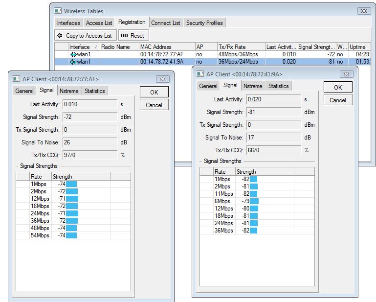

signal is very low
i have atheros 5213 chipset based card (Tp link wn 651g 100 MW) & 12 dbi 90 degree sector antenna but my client have very low signal distance clint to Ap only 5 to 800 meters with clear LOS.
& client side using 10 dbi directional panel antenna

max 20 dbm support but mikrotik show card rate txpower is only 17 dbm can i upto txpower to 20 dbm?
Sure you can, but after that, replace it with a new card.
anyway to check radio power coz in tp link web show the 20 dbm max but i have secter antenna 12 dbi & clear LOS but my signal is very low any one have idea?
