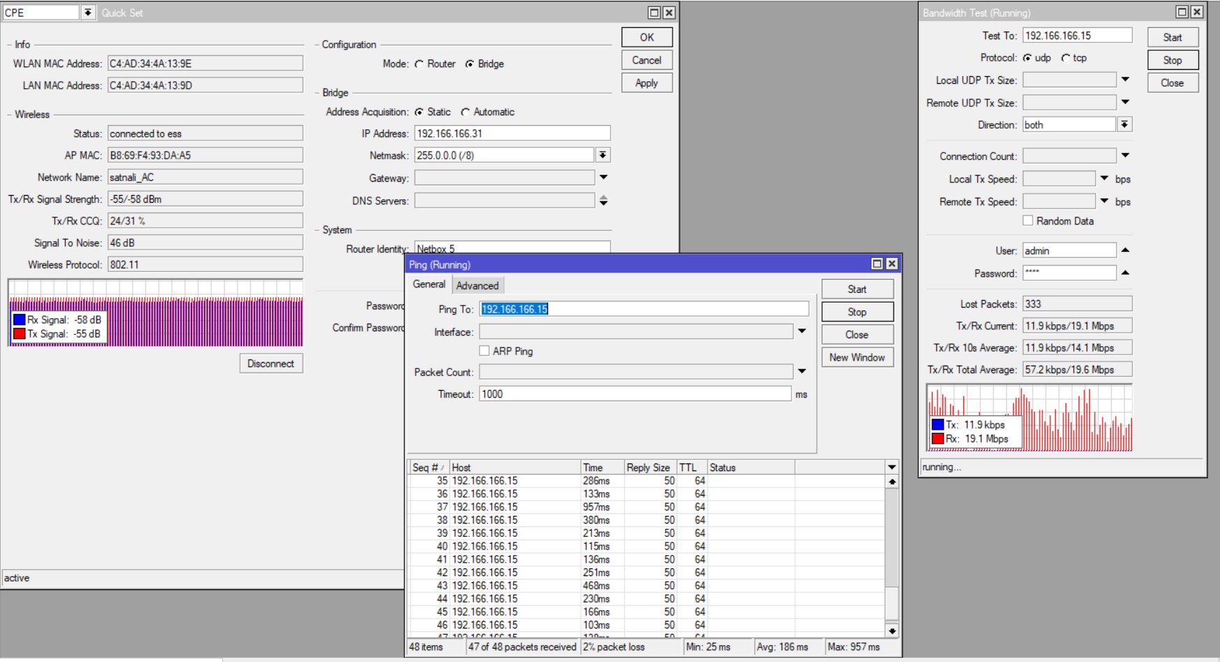

signal strong bu CCQ low
I have got PTP link with ‘LHG XL AC’ to ‘Netbox 5’ 30dbi and signal is -55/-59dbm(tx/rx), but CCQ is 24/31%(tx/rx) and i alredy chenge frequency.

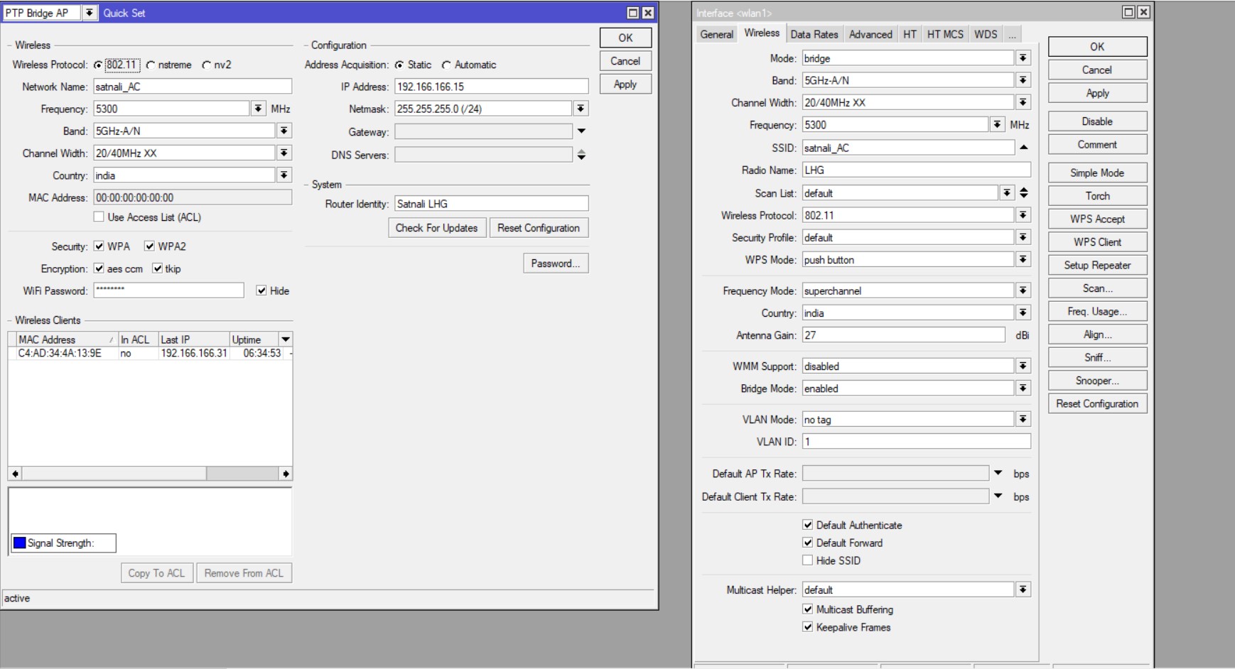

i attched screen shot of AP and CPE.

Also why are you using super channel instead of regulatory domain ?
When you change the wireless protocol let the frequency to auto and see what frequency your AP chose… Or do as @sindy suggested, a spectral scan…

CCQ is calculated from the ratio “Frames”/“HW frames”, in the detailed view of the registration. (Frames=good transmissions, HW frames is all attempted transmissions)
46dB SNR should give a very good CCQ and interface rate (like “400Mbps-40MHz/2S/SGI”). Some obstruction will ruin this however.
I expect good signal reception at the LHG XL AC due to the antenna gain. But what is available at the other end? (Antenna gain DOES NOT send a stronger signal, India EIRP limit applies. The reception however is better)
Very awfull PING RTD times ! ‘x*7’ retransmits (x interface rate step downs, 7 failing hardware retransmits before step down). Very asymetric TX/RX rates. Interface rates checked at both ends?
