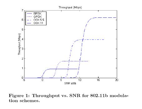

Around 20dB SNR or better should get you close to the maximum air data rate - depends how much you are pushing through the connection. A lower SNR will mean a lower data rate will be selected.

Your snr is just fine. But your CCQ is terrible. Try another channel. CCQ should be above 75% and the closer to 100% the better.
If you don’t see any improvement in CCQ on other channels then you probably do not have clear enough LOS.
