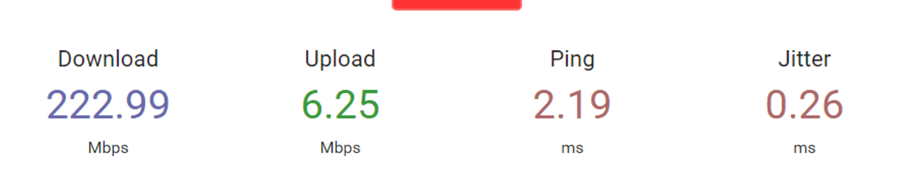

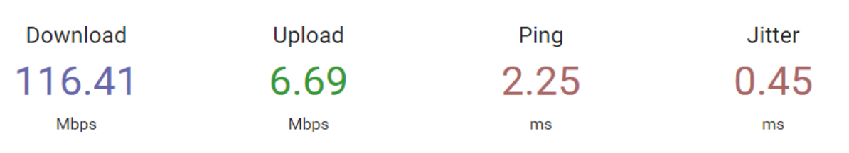

Just ran a test the results have been attached below.
CPU ran up to 6% as a max during the speed test for about 0.02 of a second. Then held fairly steadily between 1-3% until the test was completed.
Should be noted that my ping when directly connected without the router is about 0.89.

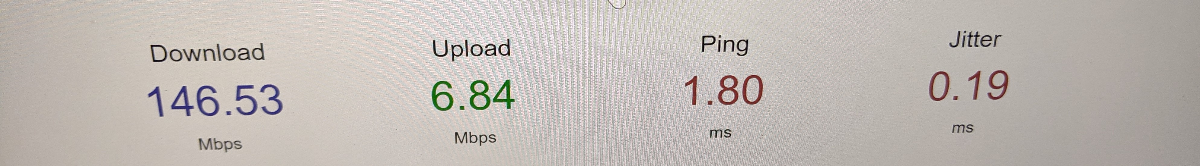

Also the results of the new speed test …

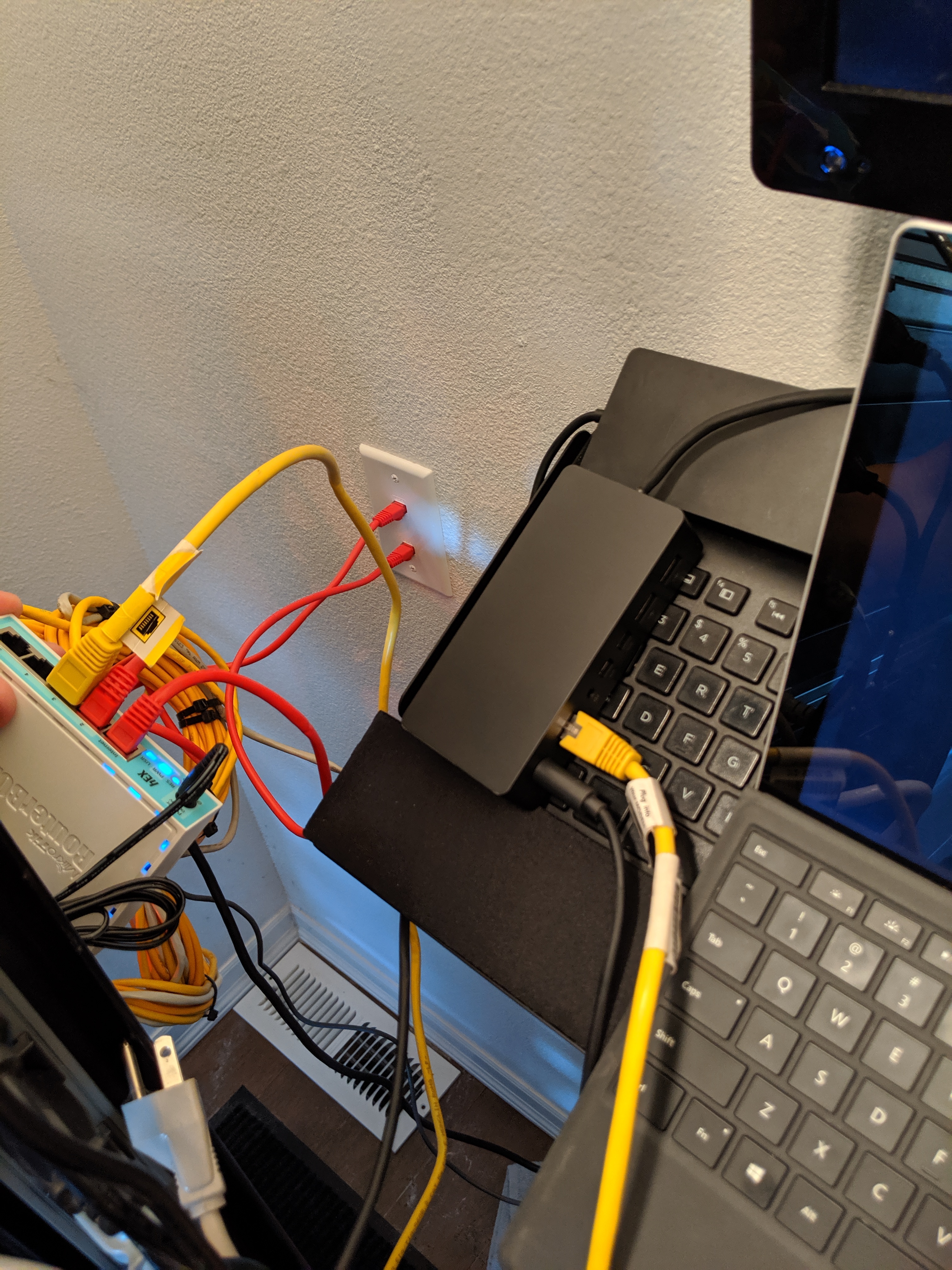

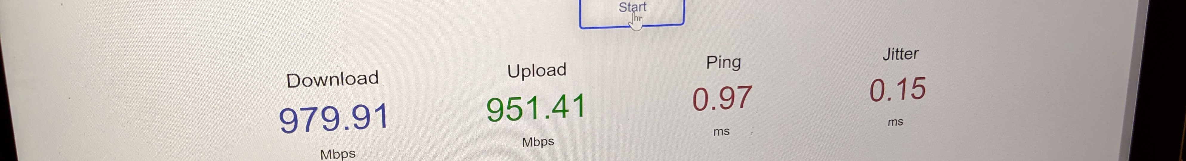

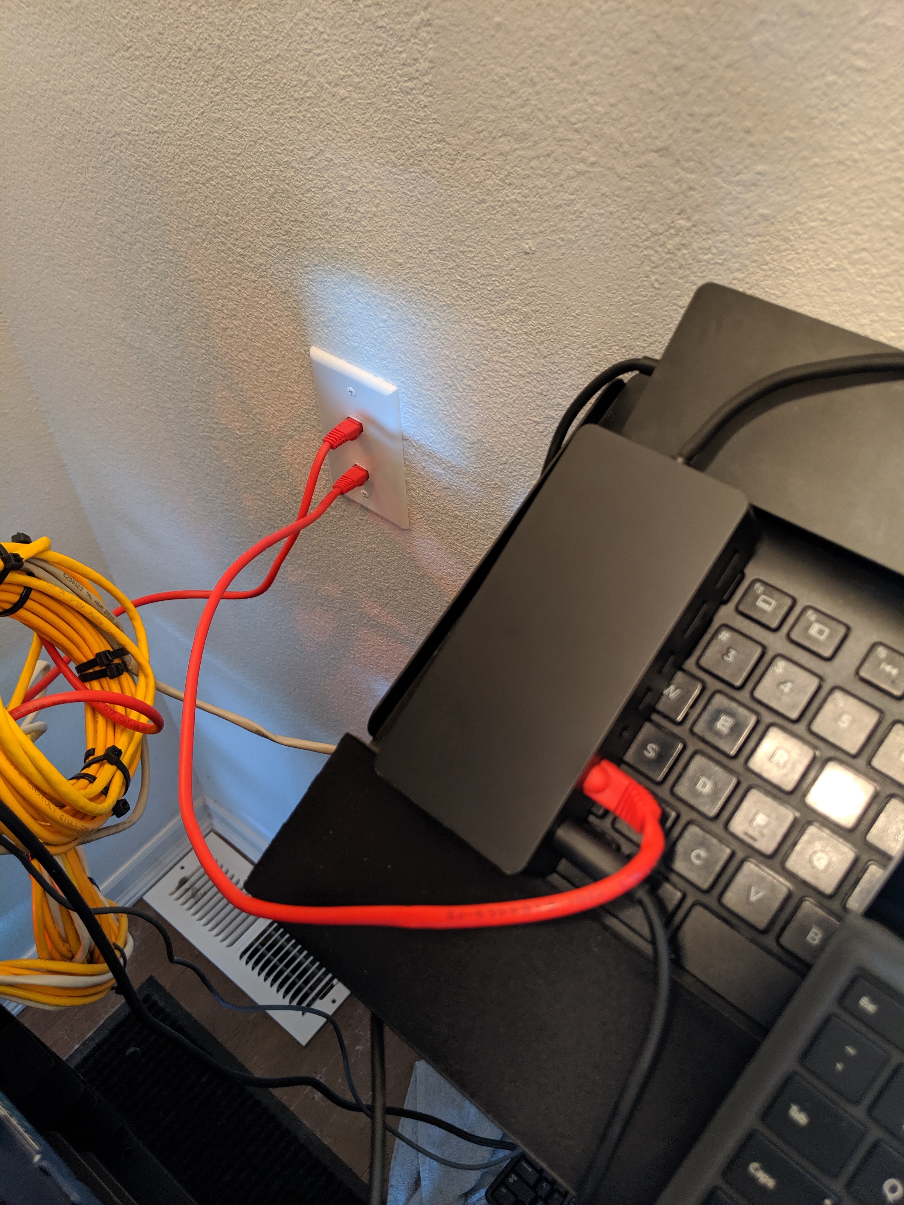

Just to post verification that the lines appear to be in working order.
Test w/ ROUTER hooked up and computer hooked directly into router
Test w/o ROUTER and internet line hooked directly into the computer
Side thought … Is there any reason why a computer might be able to read a combination of different kinds of wiring such as T568A vs. T568B better than the router? I did redo the wiring in the patch panel about the same time this problem started. But since the computer gets a perfect connection I have ruled out anything problematic there.

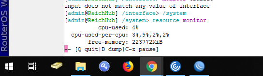

Just to keep the progress of this up to date. Been working in tangent on this with the MikroTik support team. They requested the same CPU monitoring in screenshots sent them.
This testing was in line with the original testing done above. Resource usage during test:

Sorry for the delay in updating this post …
The issue has been discovered. I worked this issue from this end as well as working with our local ISP (we are a small community makes it easier).
Apparently the FIBER boxes that we have in the house do not recognize new routers correctly without being rebooted. So the system has some kind of fault that occurs that causes a degradation in speed until the system has been rebooted. But since I was doing testing from the ISP box and switching routers while I was rebooting. I never was able to determine a fault with the ISP box and not with MikroTik.
So in this case the problem was with the ISP machinery.
Either way, I appreciate the communities support in helping to find a solution to the problem!
