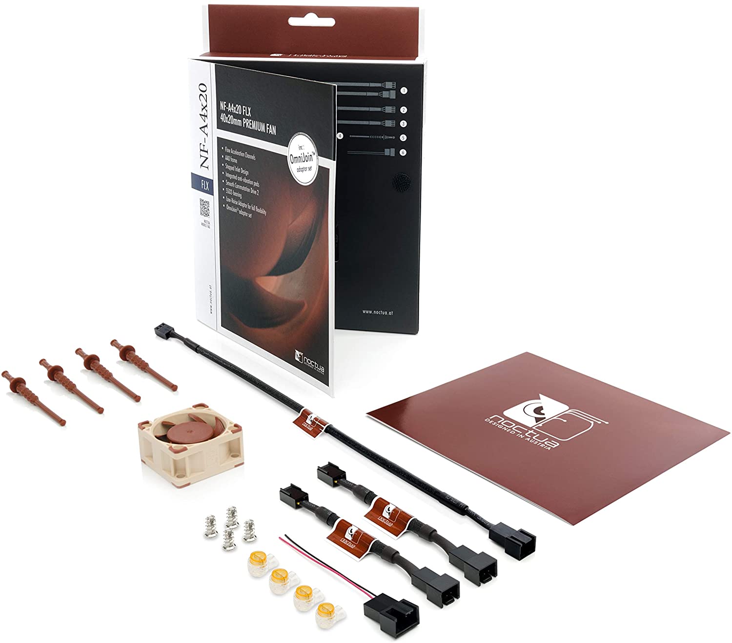

Final setup
  • Main fan header split into two (with NA-YC1, had them from previous purchases)
  • Each fan got an ultra low noise adaptor (NA-RC7 placed between the fan and the splitter)
  • 2x Noctua NF-A4x20 FLX (12V fans, 20mm thickness)
With this setup the temperatures are under control 54-55C and fans spin at ~2600 RPM (at least WebFig reports it)
The router is silent now and ambient noise is once again dominating.
You don’t have to use the parts listed here, any 3 or 4 pin Y splitter will work, you can make your own low noise adaptors with resistors and you can probably do it with original fans (as RPM’s are low).

I just went through this exercise. Thanks for all the info! I was able to get mine down to an acceptable level with the NF-A4x20 Noctua fan and the Ultra-low noise adapter. (NA-RC12). I just replaced the main fan with this fan and the RC-12. I didn’t go through the splitter and using 2 Noctua fans. I also noticed that I had a really hot switch right under the router in my rack. I moved that switch away from the router and that seems to have helped quite a bit as well. Router is sitting at 57C and QUIET. Oh so quiet! Thanks again!
BTW, I found the kit on Amazon. Noctua NF-A4x20 FLX, Premium Quiet Fan, 3-Pin (40x20mm, Brown). $14.95
