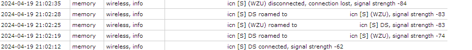

Here you can see the relevant log entries (MAC removed for obvious reasons :wink:):
Furthermore, I still get warnings about “disconnected, SA Query timeout, signal strength -78”, although they have become fewer after enabling “FT” and “FT over DS” for every WiFi interface.
Are these issues known? What shall I try?

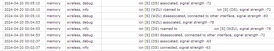

Enabled debug logging:
Any thoughts?

BTW, the logs, shown in first post, actually show two “roamings” in 3 minutes time (with a possible third one, the earliest log entry shown might be part of messages of a previous roaming). The first one is weird as station seemingly roamed to a worse AP (signal strength -72dBm before move, -78dBm after) so device decided to head back (probably, you redacted AP names so we can only guess).
