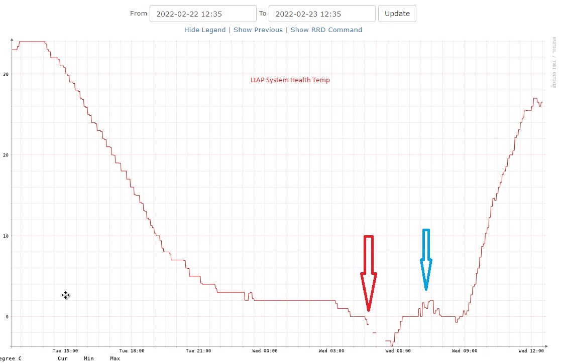

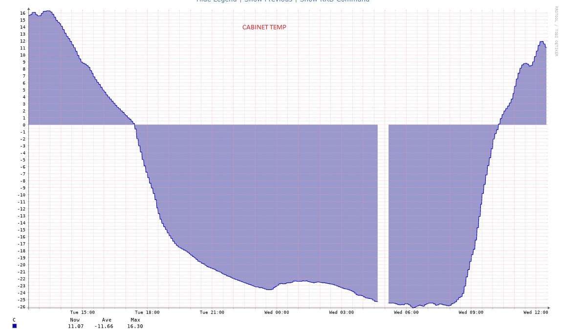

Funny, I too am just experiencing this Sim Card issue. Its -26 Deg C outside ambient. I have the LtAP in a cabinet. The system board temp in health was reading -1C when I first had this issue. I do not think this has been this low before, but I may be wrong. I checked my libre logging, and it has been below 0 only once a long time ago. This happened at approx 5am when it was the coldest. I knew this dropped as it has a always on VPN that dropped. - got alerts.
Got me thinking, is this due to temp causing the processor or something on the board to malfunction? So as a joke, I ran a speed test from this device to send to another at 800Mbit, just to warm it up a bit. Got it up to +1 Deg C now. Occasionally 2 Deg. Was hoping that the increase in temp may solve a contact issue with the sim card, or some other cold related issue.
I have power cycled the device ( its connected to a netpower 16) I have tried chnging from sim 3 to 2, and back, reboot, etc, any combination of stuff you can think of. Still cannot get the SIM to register as being present.
The LtAP is a cellular backup for a tower location. Its been in the cabinet, and no entry has been made or any disturbances to the cabinet and inside.
I will follow up with this if the warming by processor solves this issue. But it seems like I will have to do the 2 hour drive to go fix this.

Don’t know if you want to call this solved… BUT, mine now connects. System Health is at 26 Deg C. Now I am sure it would of worked before, but I was sleeping so I did not get a chance to try it at any temps between 1 Deg C and 26.
I did LITERALLY nothing other than disbaled the LTE interface, then re-enable, and it changed to registered and functions.
Note: the LTE interface was ALWAYS enabled up until the point i manually disabled it. So unfortunately its not automatic.
I did have access from the ethernet side of the device to do this however. If it happens again, I will wait for the same scenario with temps go up, and then do a power cycle.
Saved me 2 hours driving!
Images are of temps. Red arrow is where issues started, then used failover route to continue logging.
Blue is where ran speed test between two MT devices in an attempt to warm up the LtAP , it worked a bit i guess :stuck_out_tongue:
So was it the sim card that shrunk from the cold that lost its pin contact and warming it up fixed it, or does the sim card just stop functioning at such cold? I never had this issue last winter.. so you can take a guess. But I also was not logging temps and had different things in the cabinet that may have kept it warmer. I used to have about 8 POE injectors, and now i’m just using a netpower 16P. I have also cut a couple holes in the cabinet for venting, where the heat is now naturally exiting, and before it may not have.
