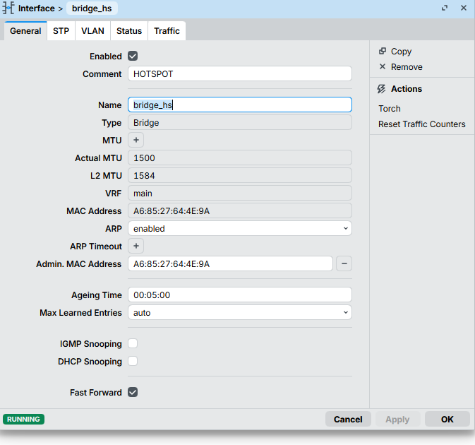

I have set up VRRP for 2 Microtik. Everything was fine. But when the configuration was connected to the switch, a storm started. According to the switch logs, I realized that the same mac address was coming from both microphones.
I checked the devices and found out that the mac address on the Bridge interfaces of both Microtics have an identical mac address.

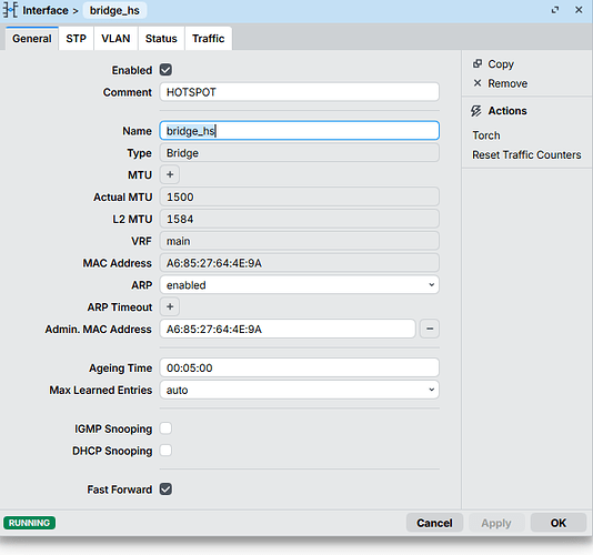

Both Mikrotiks have identical MAC addresses.
I reset the router settings programmatically and set it up again, but the mac address remained the same again.
Then I rolled back the routers to 7.20.8, set up the routers again and it helped.
Now the Bridge interfaces have different mac addresses. But I would like to understand the reasons.

  1. The configurations for both routers were created separately. The configurations do not explicitly specify the MAC address for the Bridge.
  2. I performed a hard reset before setup.
    In version 7.21.2, after setup, the MAC addresses were the same.
    In version 7.20.8, after setup, the MAC addresses were generated differently.
