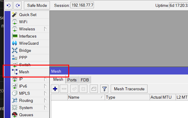

ever took a look into mikrotik mesh functinality? (i am not talking about any of AC/AX roaming extensions)
