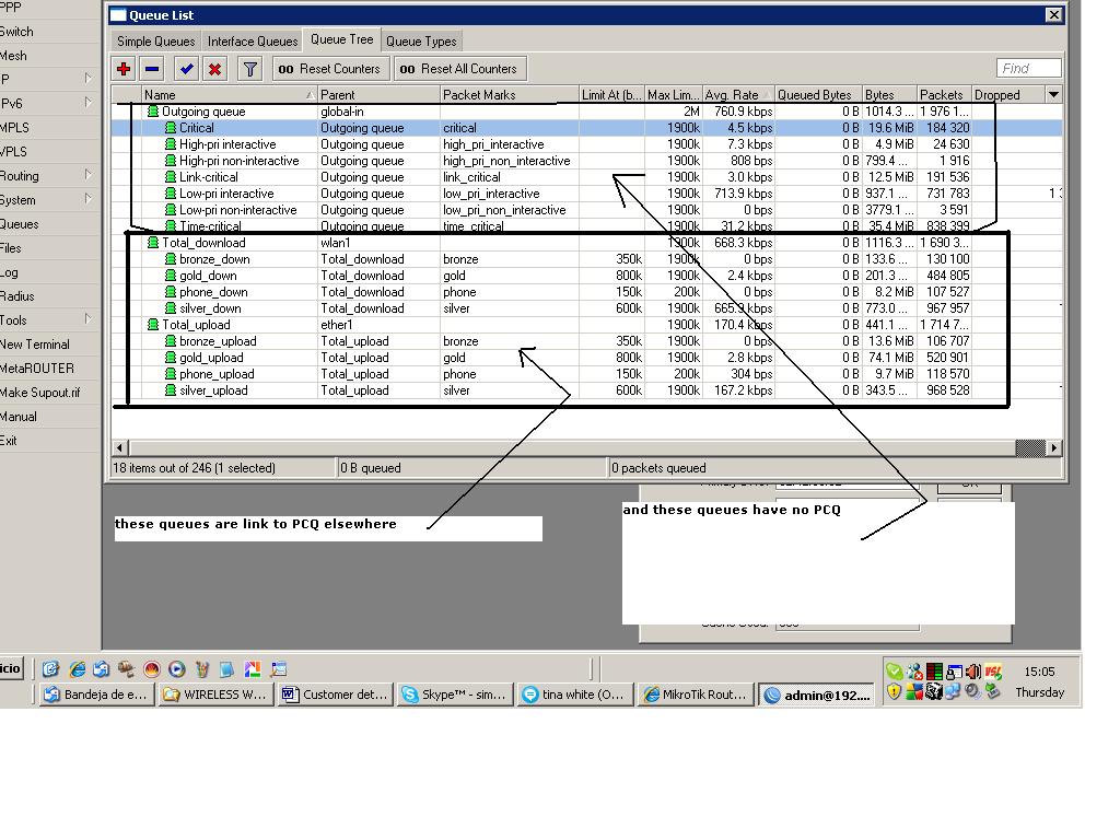

I think what this guy may want to know is a similar question to my own.
Does the prioritisation work when the queue is “loaded” ie when the “limit at” is approached. Or is it simply the case that priority does not happen unless either Max-limit box has an entry and/or CIR.
Note, there may be some of us who simply want to push some types of traffic through our networks before other types! regardless of whether the highway is congested or not.

However, if it helps I can confirm that even if the max-limit of the “child queues” is set to within 10% of the parent (maximum pipe size)something happens, but its hard to guess whether when the queue is in the “green state” whether any form of prioritising has started. I understand the following:
0% - 50% available traffic used - green
51% - 75% available traffic used - yellow
76% - 100% available traffic used - red.
So it maybe that no prioritisation begins until 51% of Max-limit. Until we have further input from Normis, I suppose its anyones guess, but the average reply on this subject is from contributors who have mis-understood the question that we have asked.

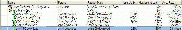

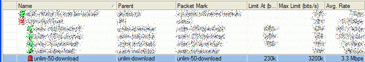

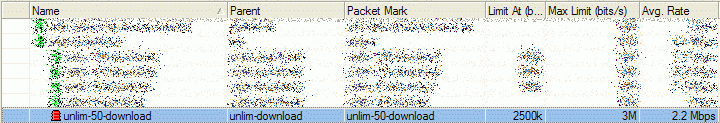

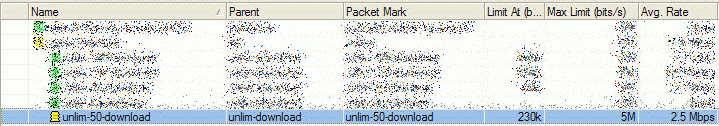

color of queue is just a color =) it shows current traffic of the queue and has nothing to do with packet processing. you can have red queue with ‘limit-at’ still not reached, and you can have green queue which drops packets
smaller number of priority for the queue which reached ‘limit-at’ traffic is just higher possibility to borrow the bandwidth from parent queue. otherwise the bandwidth will be borrowed equally
so, ‘priority’ value is used only if you have set ‘limit-at’ value

and this one is just perfect example, ‘limit-at’ is still not reached, but the queue is already red =)

Yes, Chupaka and macgaiver are correct on this matter. In pictures the Chupaka posted, check his Queue parent color. The keyword here is “available” traffic.
