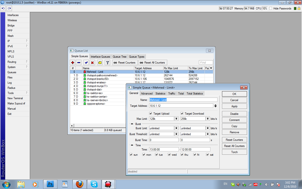

Hello everyone. If I manage to set this up properly, it would be a huge plus to my network. Please if you could assist me with this, I would be really pleased.
What I need is a simple queue which would set users to a certain bandwidth limit at a certain time.
What I want to do is set download and upload limit from 16:00 to 00:00 (midnight).
Basically, what I’ve figured out alone is how to make a simple queue for a single user and dragging it on the top of the queue list to have a priority.
Whatsoever, only thing I managed to make is limit in download and upload but when I try to use P2P option for an example or time, the queue generated by hotspot get a priority and that rule is applied instead of the one I made manually.

Note - Check out the screenshot I’ve attached into my post.
Queue trees attached to global-in and global-out always override simple queues. Use those instead.

Not if the queue tree is attached to global-in or global-out. Interface queues tree do come after simple queues.
I override dynamic Hotspot simple queues the same way to be able to use PCQ.
Simple queues really just transparently generate items in global-in, global-out and global-total. I know the manual says:
If you have simple queues and queue tree in the same HTB - simple queues will get traffic first.
But that isn’t how it actually works.

You are totally correct. I tested it out using the same packet mark for a Simple and Tree queue. The Tree queue gets the packets before the Simple queue.
