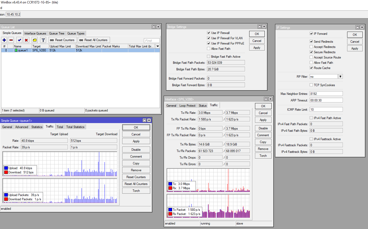

I have Vlan with simple queue on it. That Vlan added to bridge, no IPs on it. I see both ways traffic on that Vlan, but almost nothing in Queue. How can i limit that speed?

Yes. In both cases vlan attached to bridge, no IPs on bridge. Unknown traffic could pass thru that vlan, like PPPoE or any other non-IP or broadcast/multicast. Any traffic should be limited by that queue.
That is not the case: it depends… in case of simple queue on your configuration. If the traffic is switched / bridged and “use-ip-frewall” is not set, it will NOT pass through simple queue.
So you’ll need to either set that or change queues used.
On queue manual page (linked earlier) you’ll notice there are 2 types of queues: simple & tree. The last one is linked to interface and applies at different point: → “Interface HTB” just before physical transmission.
My problem solved by mark packets in Bridge - Filters and use Queue Tree with Out interface as a Parent
