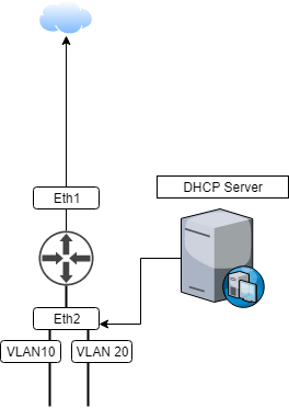

I was just wondering if there was a good way of setting up a DHCP server so that if we had a trunk port with multiple VLANs on it we could assign IP addresses, using the same IP pool?
This diagram shows what I’m going for.
So devices on VLAN10 and VLAN20 would pull IPs from the same DHCP server.
Thanks for any help.

Basically I’m getting handed a cable that will have multiple VLANs on them, and I need to route them to the Internet.
DHCP server on the VLAN interface works - but I was hoping to not have to setup a DHCP server for each VLAN.

But I am trying to have the Mikrotik be the DHCP server and hand out IPs on a per VLAN basis - but in Mikrotik, the DHCP server needs an interface to operate on. It works if I assign a DHCP server to the VLAN, but I can’t assign the DHCP server to multiple VLANs.
Not really sure why you want to do it, but although you can’t assign the same DHCP server to multiple interfaces, you CAN assign multiple DHCP servers to the same DHCP pool. Don’t know how well it works, but it let me do it as a test - only left that way for 20 seconds so did not test how well it works.

I think the diagram in the OP is confusing, since it appears there as if the DHCP server is on an external host (like a windows server with a dhcp server)
