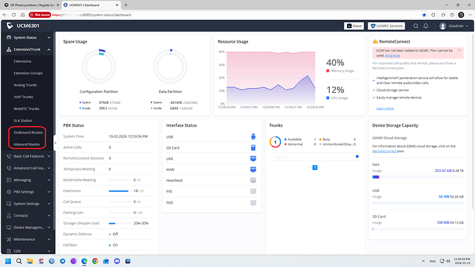

Your client must configure Outbound Routes and Inbound Routes from his PBX if his phone registered if I’m not wrong
