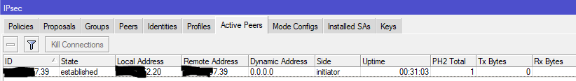

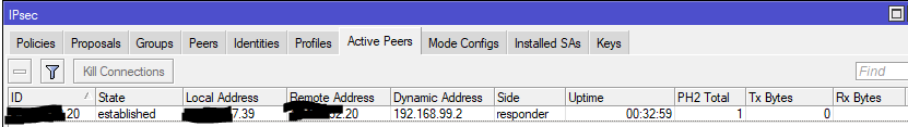

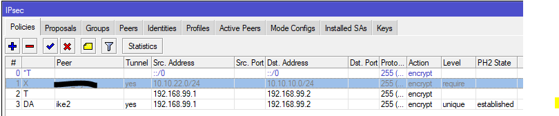

Tunnel seems to be established. But there is no traffic. Ping timeouts.
There are few things that concern me – but I do not know how to deal with them.
Dynamic Address at IPSec/Active Peers at clients side is 0.0.0.0

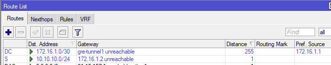

Unreachable gateways at route list

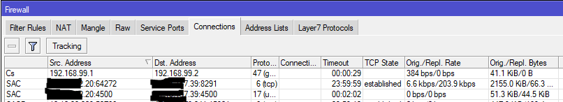

Can anyone please send me in direction to solve this? Is there a problem with firewall, NAT..?
How can I diagnose the problem so I would know where to look for the solution?
