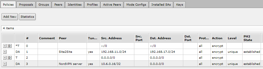

But: I cannot reach the remote peer …
Trying to ping 192.168.17.1 (LAN-IP of MikroTik-Router on Dynamic-WAN-side) from 192.168.11.x (local Subnet on Static-WAN-side) will result in time-out. Any ideas on this (hopefully) last problem?
Edit: Each time a ping-packet leaves my LAN, the “TX packets”-count under “IPSec” > “Active Peers” increases by one. “TX Bytes” increases appropriate (60 Bytes). But “RX Bytes” and “RX packets” are always zero.
The reason is very similar, firewall rules. Again we talk about chain input of filter as you want to talk to the Tik itself.
You’ve earned bonus points for realizing that you need to use the proper source address for the ping :slight_smile:
The IPsec payload packets decrypted from the IPsec transport ones inherit the in-interface attribute from the transport ones, so they hit the “drop whatever did not come in via LAN” rule again - from the point of view of the firewall, they are unrelated to the transport ones (which is a correct approach if you think about it). So you have to add an accept rule like chain=input in-interface-list=WAN ipsec-policy=in,ipsec src-address=192.168.11.0/24 action=accept before that “drop the rest” one.
Ah, think I got it :slight_smile:
Just thought, that when my packets arrive on the other tunnels end, then the tunnel would already have bypassed its payload beyond the firewall into the destination subnet.
I will visit the other site again tomorrow and I will apply this additional allow-rule. Quite sure that it will do the job :slight_smile:

There is a difference in how the firewall handles a packet for the router itself and how it handles a packet for for another device. The former is handled by filter chain input, the latter is handled by filter chain forward. And in forward, you do have rules that accept any incoming IPsec payload: chain=forward ipsec-policy=in,ipsec action=accept comment=“defconf: accept in ipsec policy”. In fact this rule is slightly dangerous as it accepts also eventual incoming connections that arrive via your NordVPN connection.
But I forgot to tell you about one more thing - since both your routers have a public IP on their WAN (and it doesn’t matter that one of them keeps changing), IPsec uses bare ESP to carry the payload. And for multiple reasons, the firewall does not handle the ESP traffic as related to the IKE one, so if there is a long silence in the traffic between the LANs, the pinholes for the ESP time out at both ends. And since ESP packets are currently only allowed to create a new pinhole at your home, IPsec payload connections initiated from your inlaws’ home will succeed, but IPsec payload connections initiated from your home to the inlaws’s site will not as the ESP packet carrying the initial request will not get through. So to resolve this, you have to add a corresponding permissive rule to chain input of filter also at the inlaws’s side. Depending on the severity of your paranoia, you might want to restrict the source address of that rule to the static IP of your home; at home, you would have to use a more complicated setup where the current source address of the inlaws’ device as seen in the IKE packets would be stored to an address list with a lifetime of some tens of minutes and the rule accepting ESP would match on that address list.
Not much more to say, but: Works like a charm!!! :slight_smile:

Perhaps you have noticed: My ROS (config on static-IPv4-WAN-side, see above) tags traffic from 192.168.11.176/28 as “via_NordVPN” by applying a “mangle new-connection-mark”.
My Killswitch-approach: Added “connection-mark=!via_NordVPN” to my Masquerade-Rule :sunglasses:
This is not a quite good Killswitch :unamused:, since I expect packets leaking out to the internet using private IPs - But (as all my traffic is TCP-based) no sensitive data will leak, because replying to private IPs is not possible from internet-view and so there will never be a valid TCP-3-way-Handshake. :laughing:
Now I am facing a little problem: I want to establish a 2nd NordVPN-Tunnel for separate traffic … But: ROS will not allow to exclude >two< different connections marks within a single Masquerade-Rule :frowning:
Now, that I you say …
… it’s very tempting to ask you again for suggestions: What will be the right configuration to staticly bound marked traffic to NordVPN using hard-coded routing-entries? This marked traffic should never go through my Default-WAN-GW.
I formerly found a ROS6-Killswitch-Routing-Approach, but since Routing-configuration has changed in ROS7 I was not able to adjust this configuration accordingly and moved to the (rather bad) masquerading-exclude-connection-mark-trick :wink:
That way, you have only prevented the leaking traffic from getting src-nated, not from getting sent out, as you have realized yourself.
That depends on the network distance of the eavesdropper from your router. Your ISP can add their own NAT and route the responses to your private addresses. Plus already the SYN packet carries the address of the server you were intending to connect to. So it’s again the severity of your paranoia that decides what next.
There are at least two ways to overcome this.
First, you can place two action=accept rules, each matching on another connection-mark value, before the masquerade one. While the IPsec tunnel is up, the dynamically added action=src-nat ones shadow them as the IPsec subsystem always places them to the very beginning of the srcnat chain.
Second, there is a reserved connection mark value, no-mark, so you can make the action=masquerade rule match on that value.
What does /ip firewall nat print show when the NordVPN is established? Feel free to obfuscate the IPs, I am only interested in the match conditions of the dynamically added rules.
I do not expect any eavesdropper within my ISP’s backbone next to my router … Not that paranoid :wink:
Quite easy - I did not know about “no-mark” … This will do the job!
Nevertheless, I am very curios how to solve this by applying some fixed routing, which will never fallback to Default-GW when IPsec is down.
Here is the output:
Flags: X - disabled, I - invalid; D - dynamic
*1C  D ;;; ipsec mode-config
      chain=srcnat action=src-nat to-addresses=10.6.0.9 connection-mark=via_NordVPN2
*18  D ;;; ipsec mode-config
      chain=srcnat action=src-nat to-addresses=10.6.0.22 connection-mark=via_NordVPN
*16    chain=srcnat action=accept src-address=192.168.11.0/24 dst-address=192.168.17.0/24
*1    ;;; defconf: masquerade
      chain=srcnat action=masquerade connection-mark=!via_NordVPN out-interface-list=WAN log=no log-prefix="" ipsec-policy=out,none
*A    chain=dstnat action=dst-nat to-addresses=192.168.11.254 protocol=tcp in-interface-list=WAN dst-port=80,443 log=no log-prefix=""
*19    ;;; Forward incoming Misc-Traffic to Misc-Server
      chain=dstnat action=dst-nat to-addresses=SomePublicIP to-ports=1234 protocol=tcp connection-mark=via_NordVPN2 in-interface-list=WAN dst-port=8888
As far as i remember my ROS6-Killswitch-Approach was something like this:
/interface bridge add name="NordVPN Blackhole" protocol-mode=none
/ip route add gateway="NordVPN Blackhole" routing-mark="NordVPN Blackhole"
/ip firewall mangle add chain=prerouting src-address-list=via_NordVPN action=mark-routing new-routing-mark="NordVPN Blackhole" passthrough=yes
But I was not able to convert this to ROS7.
I was also not able to apply appropriate Firewall-Rules: Whenever I suppressed the traffic successfully, the corresponding rule also prevented the traffic from traveling through the tunnel … Probably because of this insight, I recently got from you:
My guess: Whenever I created a rule to block this traffic, it engaged before IPsec - Therefore, even IPsec did not get these packets anymore.
