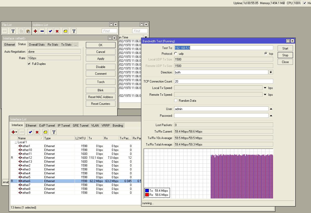

I have two routers connected to each other via a CAT6 cable.
Router A is 1100AH, Router B is a 450G. The link between the two is a full-duplex 1Gbps connection.
How come I can only get ~60Mbps of full-duplex speed on the bandwidth test?

If I only test Receive on TCP, it can only get to 150Mbps. Whenever I have tested bandwidth on a 100mbps connection, I usually get about 90-95mbps. How come I can’t get to gigabit speeds(or close at 900mbps) on Gigabit interfaces?
Nobody said that this Hardware is capable to run at this speed. It has just Gbit interface, but it is not able to handle data at this speed.
Cpu is on 100%. Do have not enough power to Btest in TCP
I guess I was expecting more out of the RB1100AH and Gigabit Interfaces.

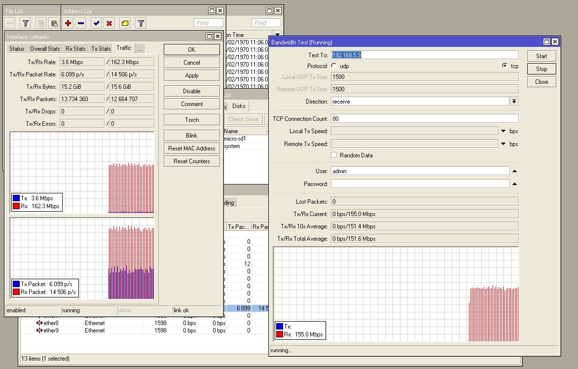

Ran from a brand new Quad Core Computer (i7-2700k). Only used 5% of my CPU on the computer - 100% on the router.
Receive TCP max 550mbps
Send TCP max 120mbps
Receive UDP max 950mbps
Send UDP max 120mbps
Send/Receive TCP and UDP max 80mbps
Looks good except I thought the Full Duplex test would be much higher.

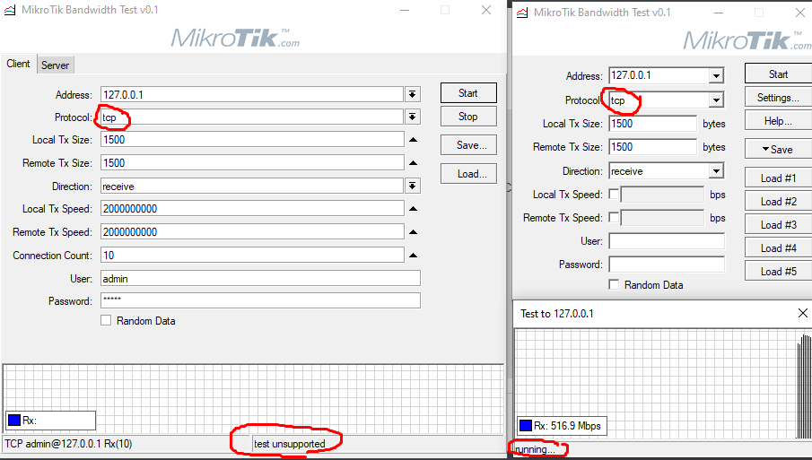

Try to set a limit to both receiving and transmitting. I have encountered when without a limit the program does not work. And note that TCP test version of the program with a file size of 750 kb is not supported. The old version of the program with a file size of 153kb does.
