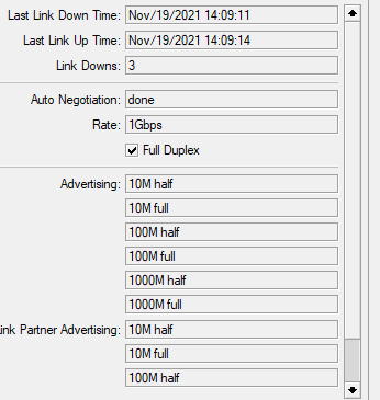

it is currently set to autonegotiate with advertise selected all the way to 1000M full - it is like this for all ports.
im using ETH4
Here is the interface connected to the modem
ok - so if i dont use masquerade and just add the port to the bridge and use the same ip range i can get 800Mbps downloads, so it is something happening after, i use the masquerade function.
i reset it again and tested without any vlans,
I see the screenshot and that says it is at 1GbE, but what about the other ports? Your original config had all the ports at 100M, and if you changed ether4 to GbE, but left the other ports at 100M, when you test from your laptop you’re still passing traffic through a 100M port and getting it throttled.
This is what you had before for ether4, but all your ports were set to 100M in the original config dump.
set [ find default-name=ether4 ] l2mtu=1358 mac-address=9C:EB:E8:06:C9:5C mtu=\
    1358 name=ether4-WAN speed=100Mbps
all my ports are the same as the screenshot, and i did not change any settings.
