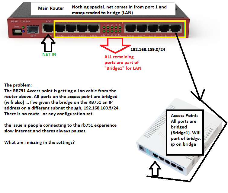

Please first see attached picture.
The problem:
The RB751 Access point is getting a Lan cable from the router above. All ports on the access point are bridged (wifi also) … I’ve given the bridge on the RB751 an IP address on a different subnet though, 192.168.160.5/24.
There is no route or any configuration set.
the issue is people connecting to the rb751 experience slow internet and theres always pauses.
What am i missing in the settings?
Please give /export compact from both devices.
Or at least tell us how devices connected to the 751 are getting IP’s and stuff.
PS. an IP on the 751 is not needed other than for remote management.

the main router is nothing special. dhcp enabled on it and just a basic home router setup …
on the rb751 i even considered adding a route that says 0.0.0.0 with gateway being the bridge interface only.
all units are connected via cable.
