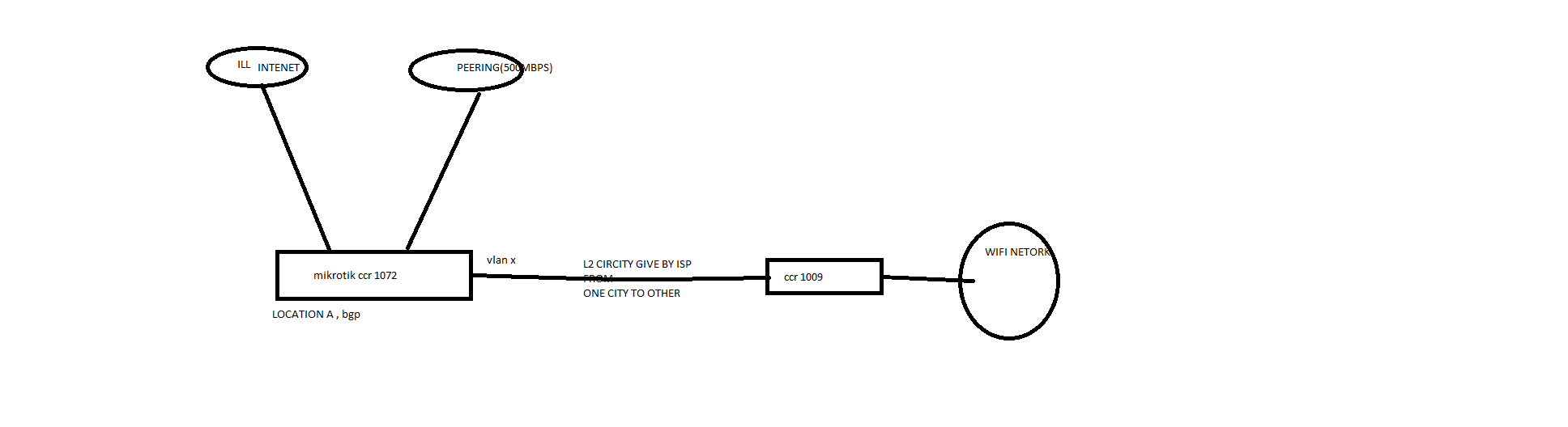

We have main NOC with two ISP as uplink (CCR 1072)… now we have taken L2 circuit from one ISP from city A to our NOC . when we configure the router of City A in bridge mode(model ccr 1009) and all the interface ip are configure at noc .. we get speed issue in whole CITY A. but if we configure the all interface and ip at City A and masqulade all …all work fine ..
request to help on this .
Diagram :-
—ISP 1-----------------|
| (NOC .. CCR 1072)-----------------------------------------(L2 CIRCUIT from know ISP )------------------------------(CITY A CCR 1009)-----------Backhaul network (wireless radio)
—ISP 2-----------------|
(here when we configure ccr 1009 in bridge mode and all the interface (Gateway ip ) configured on CCR 1072 ..SPEED ISSUE WE FACE ..but if we configure all interface and gateway ip on CCR 1009.Than no issue we faced …request to please help me ..

Alternate question for same issue:
how i can assign the multiple public IP at CITY B ? so that we can srcnat traffic of wifi backhauls to use multiple IP routed to internet .. plz explain in brief for configuration in CITY B.let say my public IP is 123.145.235.0/24 ..configure at Location A . ..
we are not able to understand the issue .but as you explain earlier ..may be broadcast will be an issue .how I can avoid if so .. we have the same network in other location where we are not getting any speed issue when we do configuration IN bridge mode. I am unable to understand why few locations have such issue.
Network diagram in brief.
--------------------------------------ILL (1G)------------------------| |
| Location A with CCR 1072 |city A->----------------------L2 CIRCUIT-------------------------------CITY B {???}—wifi backhaul
---------------------------PEERING (500 MBPS)----------------| BPG running) |
I’m afraid I haven’t understood your picture, maybe a photo of a drawing by hand would be less affected by font chosen.
What I’ve understood so far is that you have a wireless network in one city (A) and a device to which a subnet of public IPs is routed in another city (B), and you want traffic from the wireless network in City A to be src-nated to multiple public addresses which are reachable & propagated using BGP at City B machine.
