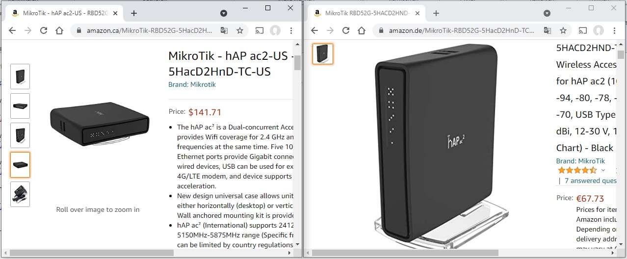

I saw dramatic differences with Ruckus as well …
Amazing, do the same with hAP ac2 or any other Mikrotik device (Amazon.ca<->Amazon.de). " You are getting ripped off @anav in Canada for this one"
Well you actually don´t buy MikroTik devices from Amazon.ca, hopefully.

bpwl my friend, you simply do not know how to shop in Canada LOL.
Amazon will sell you products from many vendors (from tplink direct for example or through third party resellers and they can charge whatever they like!!!).
But yes, one wouldn’t buy mikrotik from Amazon, well amazon.ca for sure!
Hapac2 MT USA price from website: $69US
Nominal Canadian Price and any authorized MT reseller $85 CDN
https://store.mikrotikcanada.ca/wireless-for-home-and-office/209-hap-ac2-us.html

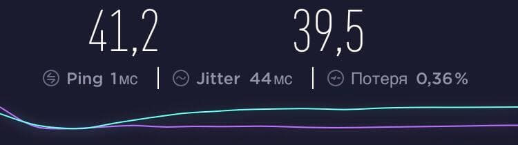

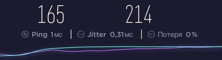

After experimenting with the device, I found out that it works differently, depending on the frequency.
5785:
5180:
Ridioether:
Only changed the frequency, nothing more… belive, or not :slight_smile:
5785:
5180:
Ridioether:
Looking at the scan list … what region is set on this device? 5785 is not part of the scan, so 5785 might not be part of the region set in the MT.
Set the correct local region in the wireless setup.
