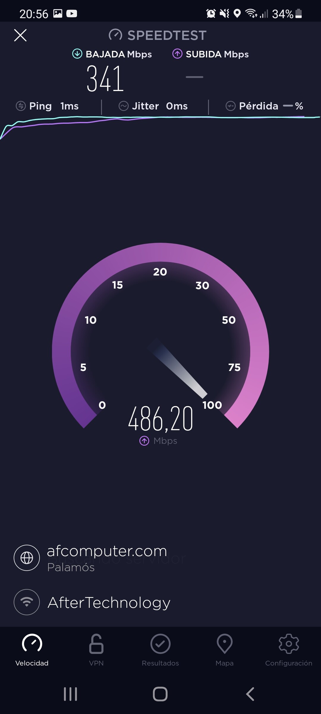

Hi all,
I'm new to Mikrotik so I apologise in advance because the learning curve here is huge and I'm a total noob.
I recently installed an Hex S to replace my ISP router in order to have more options on my network.
I also bought a Mikrotik Cap AC for wireless and I'm using Capsman to provision configuration to the AP.
The issue I'm facing is that no matter what I do, I can't get more than ~300/300Mbps on my wireless. This is specially frustrating because with my ISP router (Wifi) I can get ~600/600Mbps.
Is this an AP limitation or there is some configuration that can improve speed ? Perhaps a faulty AP ? The test results on Mikrotik site are very promising....
Also, the range is not very good. I'm using a freq that is not very used and still the range is quite bad. Any ideas ?
Here is my conf:

You missed the extensionchannel (to get an up to 80MHz bandwidth). Does the speed show connection speed, or is it real live speed tests? In the end…don’t expect (much) more than your current speeds from this accesspoint. I used to use one and in the end switched to another brand (also because Wifi doesn’t seem to have a future with MikroTik). Though I really love all the options it provides. You might want to consider to not use CAPsMAN, there are more options if configured stand alone.

For 5ghz 867/3 = 289 so that is what realistically you should expect, (with LOS) you are doing better so thats good.
For 2ghz 300/3=100 will roughly be the real world speed you will get

Data speed in wifi comes in 2 different definitions:
  1. Interface rate. The rate at which data is leaving the interface. This is theoretically defined, and Mikrotik is no exception. List of attainable interface rates can be found here: http://mcsindex.com/ .
    You just have to understand the Spatial streams (2S = two streams), MCS encoding (for ac from 0 to 9 per stream, for n 0-7 for 1 stream, 8-15 for 2 stream), and the 0.4µs (SGI) or 0.8µs guard interval. The used MCS and stream and guard interval depends on SNR and on CCQ. (Low SNR or low CCQ will make the interface step down in streams and encoding).
    So for everyone (Mikrotik and other brands), with no exception, 80Mhz/2S/SGI will give 866.7Mbps interface rate with a good signal.
  2. Payload data throughput mainly depends on the interface rate and the overhead. That overhead depends to a very large extend to the buffer size used for the transfers. Buffering happens in A-MSDU and in A-MPDU. For 802.11n and ac the maximum buffer size is known and implemented by most. (Mikrotiks limits to medium sizes only: the A-MSDU to 3839 bytes, and the A-MPDU to 262143bytes) http://forum.mikrotik.com/t/ac2-vs-ac3-wifi-not-over-200mb/148289/1 . The overhead can be calculated for any buffer size. CAPsMAN typically reduces the A-MSDU further to 2048 by default.
There is a 3th moderation of speed and that is the TCP congestion avoidance control. This is not related to the AP, but can be influenced by it, So on this 866.7Mbps interface rate, TCP is typical max at 290 Mbps, while UDP is up to 390 Mbps for Mikrotik. (medium buffers and other driver inefficiencies).
Of course any other AP or client on the same channels will consume some part of the air-time, and all other AP’s and clients will wait. If channels are different but overlap they will not wait but destroy each others transmissions and the CCQ will drop, and so will the interface rate used.
In summary mmtik, your bogus 867 Mpbs one way speeds are not based in reality.

Nah, I can get a better speed with my cap ac or hap ac2, a screenshot at the peak speed can’t fool anyone, consistency is always a problem, try to run 10 speed test continuously and you will see, everyone here complain for a reason. Also, if you have a large number of clients you will find a bigger problem of it, home user will not use these devices and enterprise user will need for capacity. If you love MT, don’t try to cover their problems, it will only result in a bad way, expose them will make them feel the pressure and work hard for a fix, this is the only way. We are waiting for your answer, MT.
Well that’s a single Client download test with MikroTik’s self made driver.
