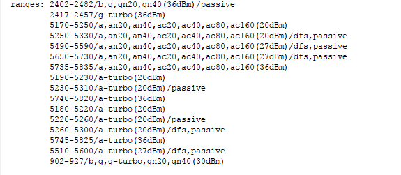

The last weeks I have had very bad WIFI in our apartment. I have an MikroTik Cloud Router model: CRS125-24G-1S-2HnD and I’m still learning how it should be setup. All our family members using the WIFI have the same experience that it’s almost useless to use WIFI at the moment.
When using my Samsung S7 phone via WIFI (SSID: WIFI ABCDEF_2G) I get about 0.33 Mbit/s down and 0.01 Mbit/s up, but when using the same phone over 4G/LTE connection I 92.18 Mbit/s down and 12.42 Mbit/s up. Also, when using the router with threaded connections it’s performs very well.
I’ll attach my router configuration, so you experienced users can have a look and point me in the right direction where to look to solve this frustrating issue?

Have you got idea what’s the point of this picture
Where DFS,passive is means on that frequency running RADAR device,and i have to avoid,right?
Can i play with frequency who is on only passive, and without description?
any more explanation, will be appreciated
