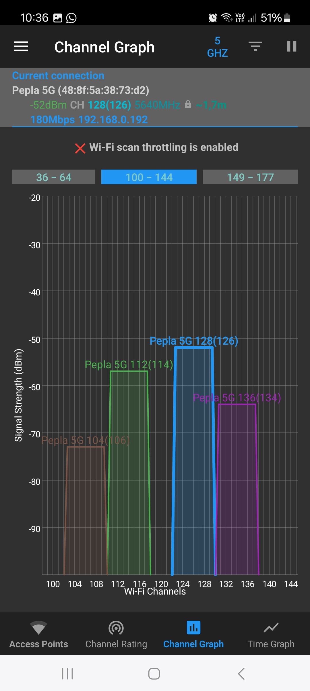

I’ve also attahced my laptops connectivity to the 5Ghz network. My laptops is the one highlighted.
Please do feel free to request any info from me. I wasn’t entirely sure what kind of info I had to upload.

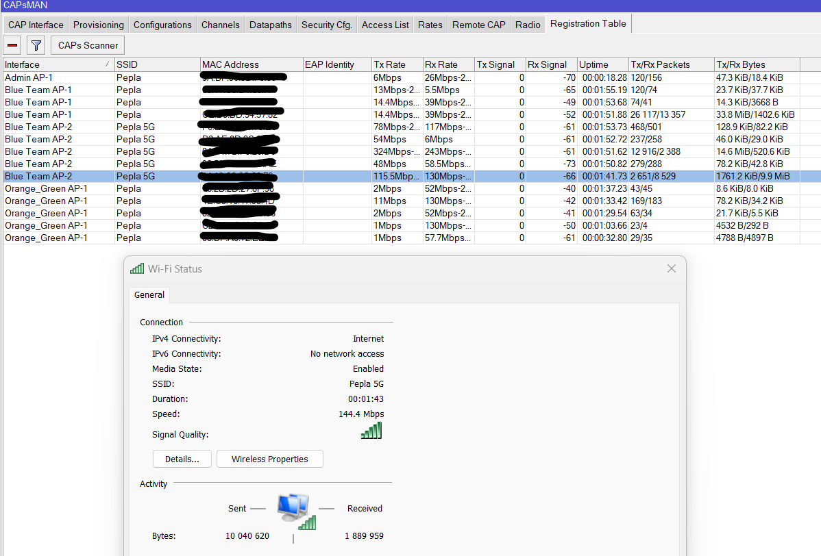

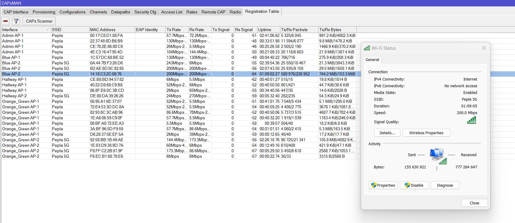

  1. Speed definitions.
  • there is the “interface rate”, that is the transmission rate (like the speed of an ethernet connection)
  • there is the max and actual dynamic rate at an instant in time for a wifi radio . Windows shows always the max rate only, not the actual rate ! (see the 144Mbps)
    -The max rate depends on the encoding (signal quality) and channel width (20,40 or even 80 MHz wide) See https://mcsindex.com/ . Find your 144,4Mbps with 20Mhz width, short guard interval, dual stream)
    -Mikrotik shows the dynamic rate (can be different for Tx and Rx). But your sessions are too short in time, and the volume too low , to see some higher speeds here. (It’s gradually building up with good trnsmissions. It drops again with missed transmissions!)
  • There is the transmission time utilisation (due to inter transmission gaps.) Important with small transmission packets. Mikrotik WLAN driver has small AMPDU size, and can only get 360Mbps with 866Mbps interface rate in the best lonesome condition. Wifiwave2 is much better , ±600Mbps on 866 Mbps interface rate
  • Wifi is bidirectional communication. There can only be ONE transmitter in a channel at some point in time! All wifi devices (AP and clients) compete for the right to transmit.
  • Any busy slow transmitter will consume a lot of air-time in that channel. (Actually reducing the effective speed of all the others, to around it’s own slow speed.)
  • There is potential interference and collisions, requiring retransmissions. Check the CCQ in Mikrotik: % of transmissions that succeeded.
  • Interference is also with bluetooth, USB3, microwave oven, non-wifi transmitters, etc etc), and also partly overlapping channels.
  • Waiting for other transmitters to finish has a disturbing range that is typical 8 times the usefull range. (So not for 40 meters, but 320 meters in free field conditions)
  • Walls and other obstructions will disturb the signal quality. (High MCS will not be possible)
  1. Once you know now what that one transmitter can do, and what the expected speed can be … then there are the Mikrotik specifics.
  • wifiwave2 will not work well on a hAP ac2. The memory available (flash and RAM) are too small.
  • Mikrotik is not using WMM priorities out of the box in WLAN driver. Using AMPDU is also not set for higher priorities.
  • CAPsMAN has it’s own potential limitations (eg Size of AMPDU in the CAPWAP tunnel used?)
  • any tuning setting has effect on the performance. Only deviate from the default if you really know why you do it, and you monitor it.

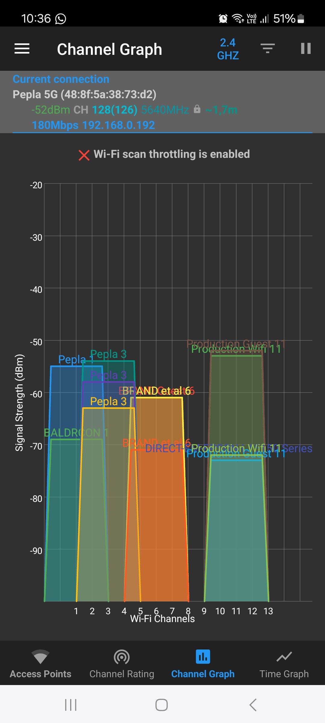

I’ve also attached a screenshot of the channels for 2.4Ghz and 5Ghz.

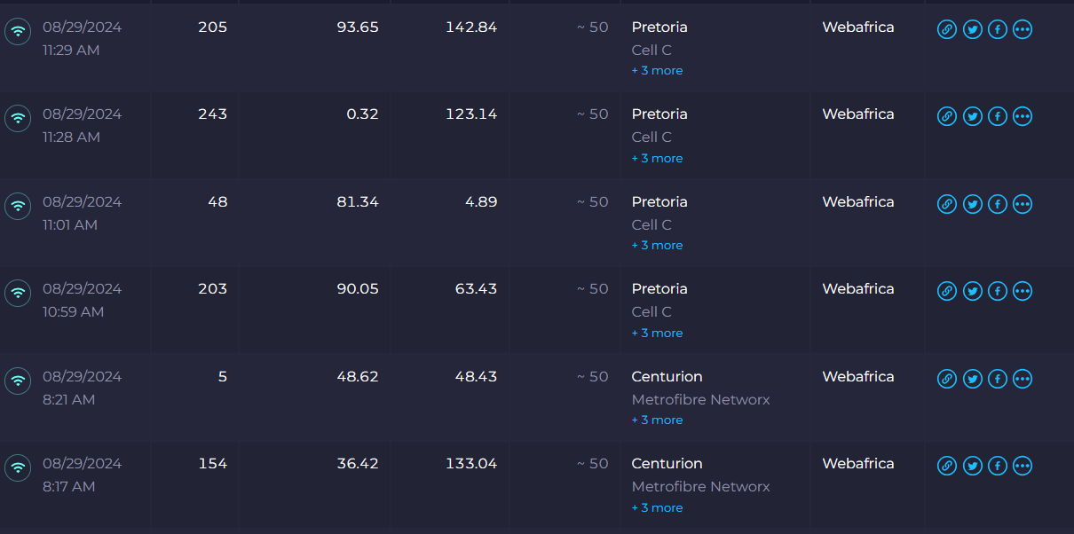

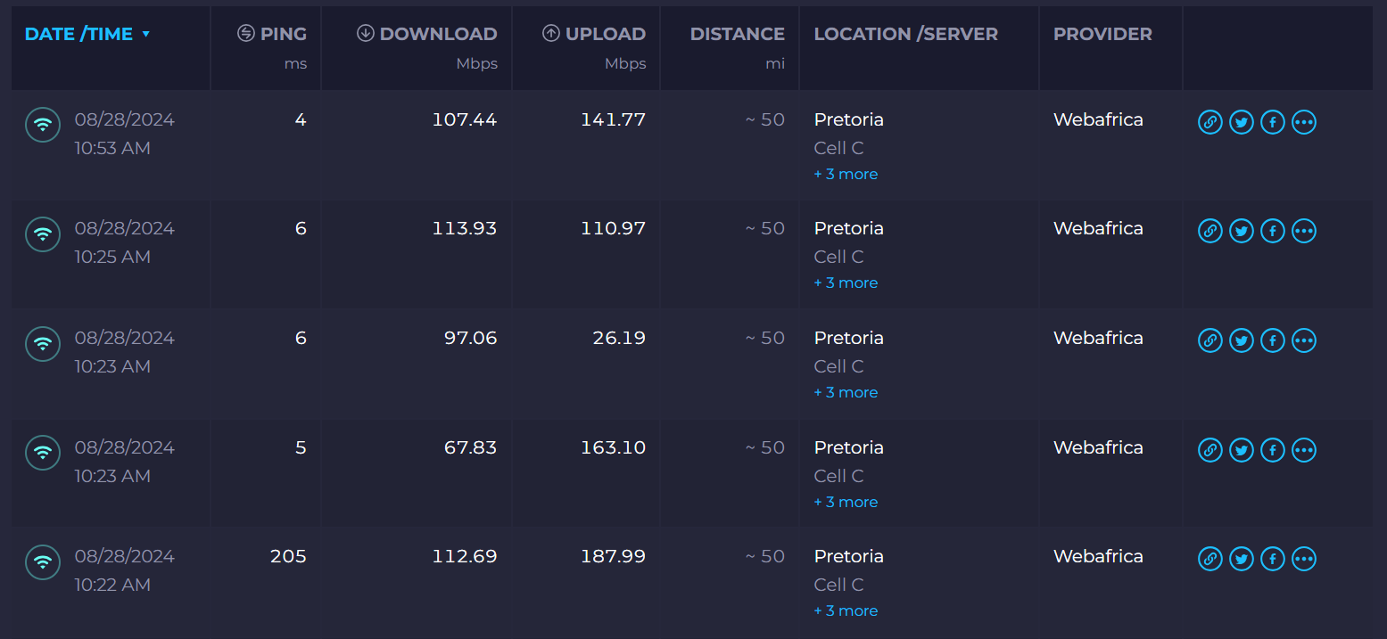

Also added speedtest. Which seems to be okay, but user still experience a “slow/sluggish” connection when connected to the WiFi.
If a wired conneciton is fast, then it is not related to the routing part of the router.
I also notice that the 2.4GHz radio is broadcasting on channels 1, 3 and 6. In an ideal world (funny in the 2.4GHz context) you would only use channels 1, 6 and 11. Might want to configure frequencies 2412, 2437 and 2462.

These very short PING delays in those tests. Over wifi ?
Long PING times do indeed make the connection feel slow, very slow, even if the rate is OK.

For the 2.4GHz, avoid the 802.11b setting. “b” gives 1Mbps beacon speed (30 SSID/AP at 1Mbps overhead will fill all the available air-time just with the beacons)
802.11b in one AP, forces other reachable AP’s to also work with 1Mbps. There are 1Mbps connections in your sample.

At the moment, we have 28 devices connected to the WiFi, Be that via 2.4Ghz or 5Ghz. My laptop would also jump between 2 AP’s. Hallway Ap & Blue AP. See attached Floor Layout of the Office. Tuesday’s and Thursday’s have the least amount of people in the office. But the WiFi still feels slow, as if the internet feels slow. Reponse time of websites are long, takes a few seconds longer for the sites to open compared to being on cable. I even have a space AP that I could install, however, I wasn’t sure if this might help and where to put it.
I was thinking of move the Blue AP out from behind the corner, behind the door it’s currently at and move it to the middle of the Blue Tables.
What is the maximum amount of Client’s an AP can handle? At the moment the Orange_Green AP carries about 10 clients.
I’m also connected to the Blue AP at the moment. But is does then to jump to the Hallway AP when I move around the office with my laptop and stays connected to it. Rx Signal would be -70 when connected to Hallway AP. When connected to Blue AP, my signal strength is -63. See attached.

To answer your question, yes. those short pings where when I was connected to the WiFi. I’ve attached a speedtest I did today as well. You’ll notice quite a difference between some of the tests.

10 clients on an AP like hAP ac2 is no problem at all. All the clients around , as checked with “Snooper” have to be counted however. “Scan” only shows the AP’s emitting beacons. All transmitters compete for air-time in the channel, AP’s and clients equally well. Clients that see the AP, but not the other clients will create destructive interference while also talking to the AP, which is listening to another client. ‘RTS/CTS’ and ‘RTS to self’ might be considered then.
