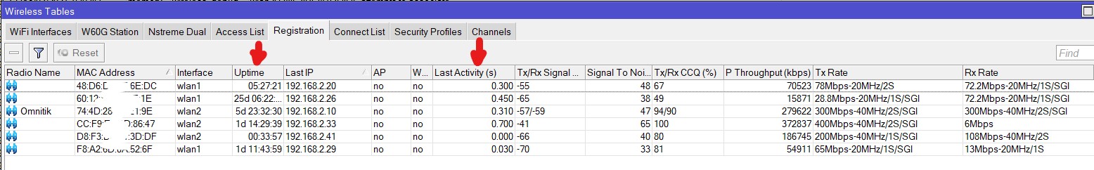

Other check is “Uptime” and “Last activity”.
Uptime: to know how long the connection is valid
Last activity: is to be live monitored. e.g. smartphones in rest make this count up to something like 20 sec , and then restart counting (they go to sleep for 20 sec). Some do drop the signal strength with 20 dB, some others stay on level.

time between disconnect and connect is about 2min, and connect between disconnect 5min.
Uptime is around 20hours, last activity is about 10-20s to restart

Uptime connection 20 hours ??? (Or uptime RouterOS?) How can this be that value for the wifi connection?
Sleepy devices! IOT with transmits every 10-20 sec ??? There is no access-list rule that checks signal strength with “allowed out of range” time ??? Heh not seen in the config.
