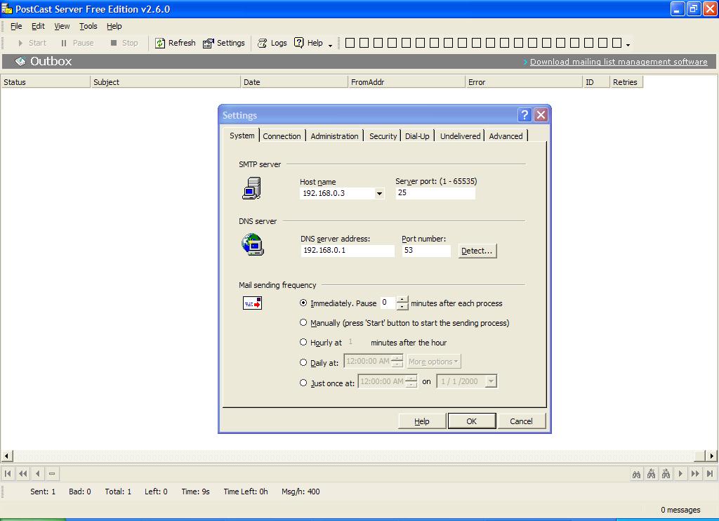

HI all, i have set up a postcats SMTP server on my computer, i setup router os to send throug the server, problem is it cant seem to contact the server correctly.. Here is the e-mail debug print out
14:04:17 system,info changed script settings by jordan
14:04:18 e-mail,debug recv: 220 PostCast SMTP server (http://www.postcastserver.
com/) ready at Wed, 23 Jan 2008 13:43:12
14:04:18 e-mail,debug send EHLO [192.168.0.6]
14:04:18 e-mail,debug recv: 500 unknown ??? command “[192.168.0.6]”
14:04:18 e-mail,debug send RSET
14:04:18 e-mail,debug recv: 250 reset …
14:04:18 e-mail,debug send QUIT
14:04:18 e-mail,debug recv: 221 closing connection
14:04:18 system,e-mail,error Error sending e-mail: error talking to server
Is there some settings i need change… I can send an e-mail from the postcast server itself, and it works great, but i cannot seem to get routeros to send from the SMTP server. I need help please… The port being used for messaging is 25 take a look at the pic for details. Thanks guys -Jordan

It looks like that you are not alowing relay or the reciver are not in the local server setting.
the commands for sending are ok.
Yes tried that its a Postcast server and under settings>security i added the IP address of the routerboard to users list so it can acces it… Does anybody recomment a differnet smtp server? -Jordan
