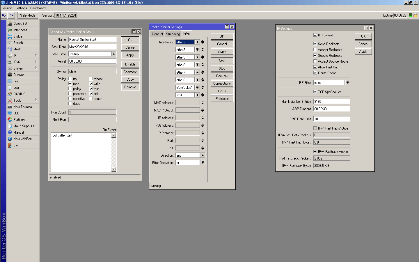

Well OK I will let you know what I have experenced so far. Seems to work great. Ive had no issues. Snort is running and the router packet sniffer is set to feed all the interfaces to it except the one feed the FreeBSD server running Snort. You gotta exclude that port or a feedback loop is created.
I assume it is not forwarding packets that are hardware accelerated. This is a obvious issue and I will disable it and see if traffic changes..
Hmmm… Looking at the fasttrack wiki it states if I have sniffer running fasttrack is disabled.
I start sniffer on startup with a script. Doing seems to leave fasttrack running AND packet sniffer running..
If I then stop and then start manually then fasttrack is disabled.
So having fasttrack start with a script on startup DOES NOT SEEM to disable fasttrack and also provides a output from packetsniffer..
See pic.. Note packet sniffer is running and notice fasttrack is enabled.

In the above pic, and in the packet stream, I can start up packet sniffer at start up and KEEP fasttrack running. As shown in the example pic. This seems wrong. It produces less packets.
If I then stop and then start packet sniffer the indicator for fasttrack goes off and I get a higher level of traffic sniffed.
Maybe a “race” condition on start-up. Try to adjust the scheduler with initial delay before sniffer start
:delay 5
/tool sniffer start
