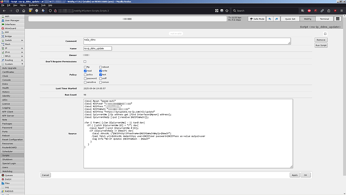

  1. The script:
In the router's GUI, on WebFig, Menu: System, Scripts >> click to Add New:
Comment [noip_ddns]
Name [no-ip_ddns_update]
Owner (your user, autocompleted)
Policy read write test
Source # put here the code (see below):
After putting the code into the Source field, click "Apply".
If there are no typos, "not invalid" should appear above, so click then on "OK" too.
Don't forget to replace "myemailaddress@domain.com", "my_password", and "user.ddns.net" with your own credentials.
The code
##################### copy & paste from below #########
:local Mywan "pppoe-out1"
:local NOIPUser "myemailaddress@domain.com"
:local NOIPPass "my_password"
:local NOIPDomain "user.ddns.net"
:local NOIPhttp "https://dynupdate.no-ip.com/nic/update"
:local IpCurrentMe [/ip address get [find interface=$Mywan] address];
:local IpCurrentNoip [:put [:resolve $NOIPDomain]];
:for i from=( [:len $IpCurrentMe] - 1) to=0 do={
:if ( [:pick $IpCurrentMe $i] = "/") do={
:local NewIP [:pick $IpCurrentMe 0 $i];
:if ($IpCurrentNoip != $NewIP) do={
:local ddnsURL ("$NOIPhttp\3Fhostname=$NOIPDomain&myip=$NewIP")
/tool fetch url=$ddnsURL mode=https user=$NOIPUser password=$NOIPPass as-value output=user
:log info "NO-IP Update: $NOIPDomain - $NewIP"
##################### until here ######################

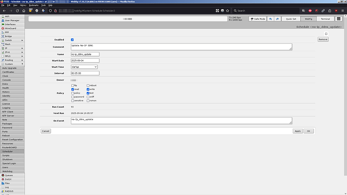

  1. The scheduler
In the router's GUI, on WebFig, Menu: System, Scheduler >> click to Add New
check Enabled
Comment [Update No-IP DDNS]
Start Date [Sep/04/2025] (for example)
Start Time [22:00:00] (for example)
Interval [00:05:00]
Run Count (xx, autocompleted)
Next Run (Sep/04/2025 23:00:00, for example, autocompleted)
On Event [no-ip_ddns_update]
click "Apply" then "OK".

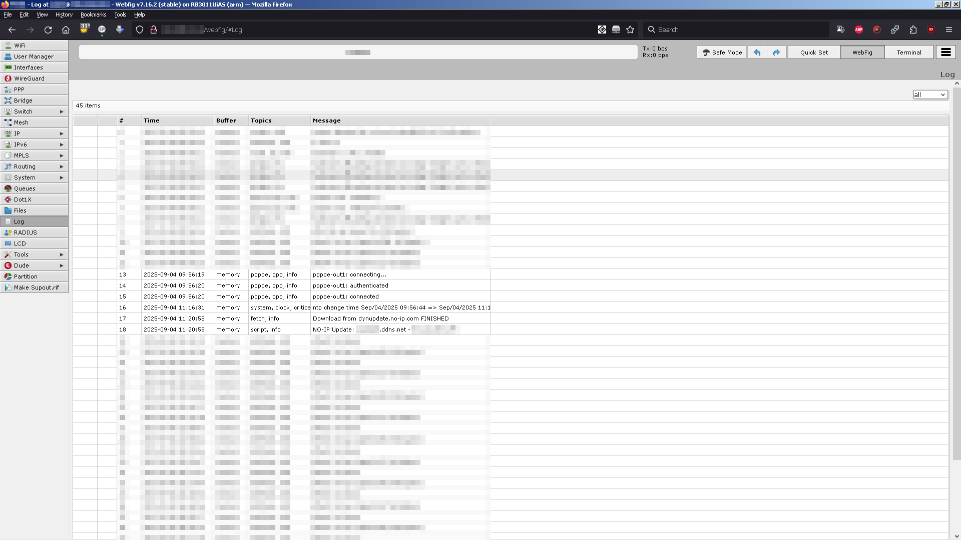

  1. The logs

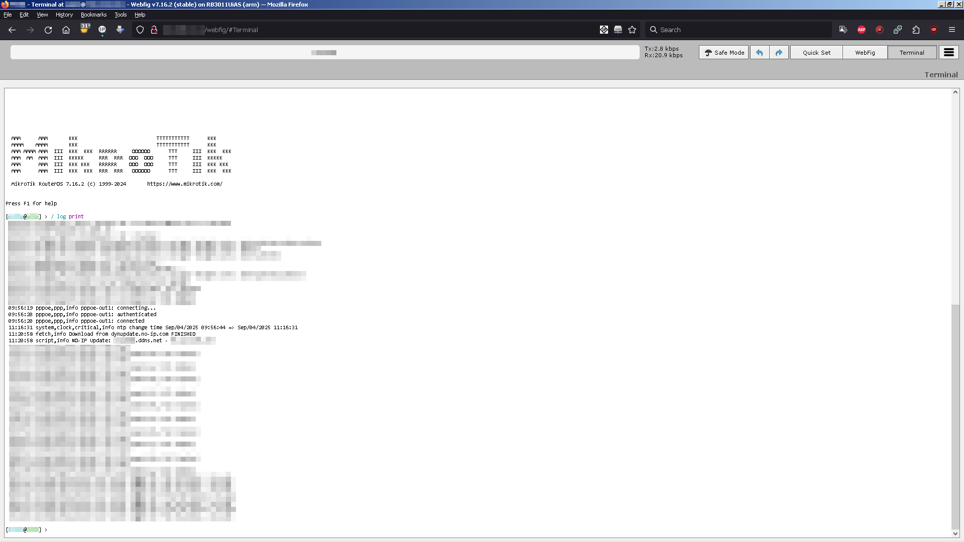

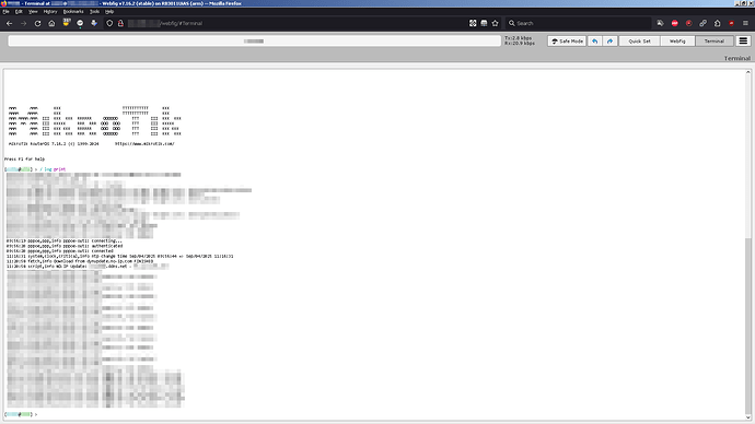

Watch it, in GUI, on WebFig, Menu, Log or in CLI:
[user@router] > /log print
09:56:12 pppoe,ppp,info pppoe-out1: initializing...
09:56:12 pppoe,ppp,info pppoe-out1: waiting for packets...
09:56:19 pppoe,ppp,info pppoe-out1: connecting...
09:56:20 pppoe,ppp,info pppoe-out1: authenticated
09:56:20 pppoe,ppp,info pppoe-out1: connected
11:20:58 fetch,info Download from dynupdate.no-ip.com FINISHED
11:20:58 script,info NO-IP Update: user.ddns.net - XX.YY.WW.ZZ
