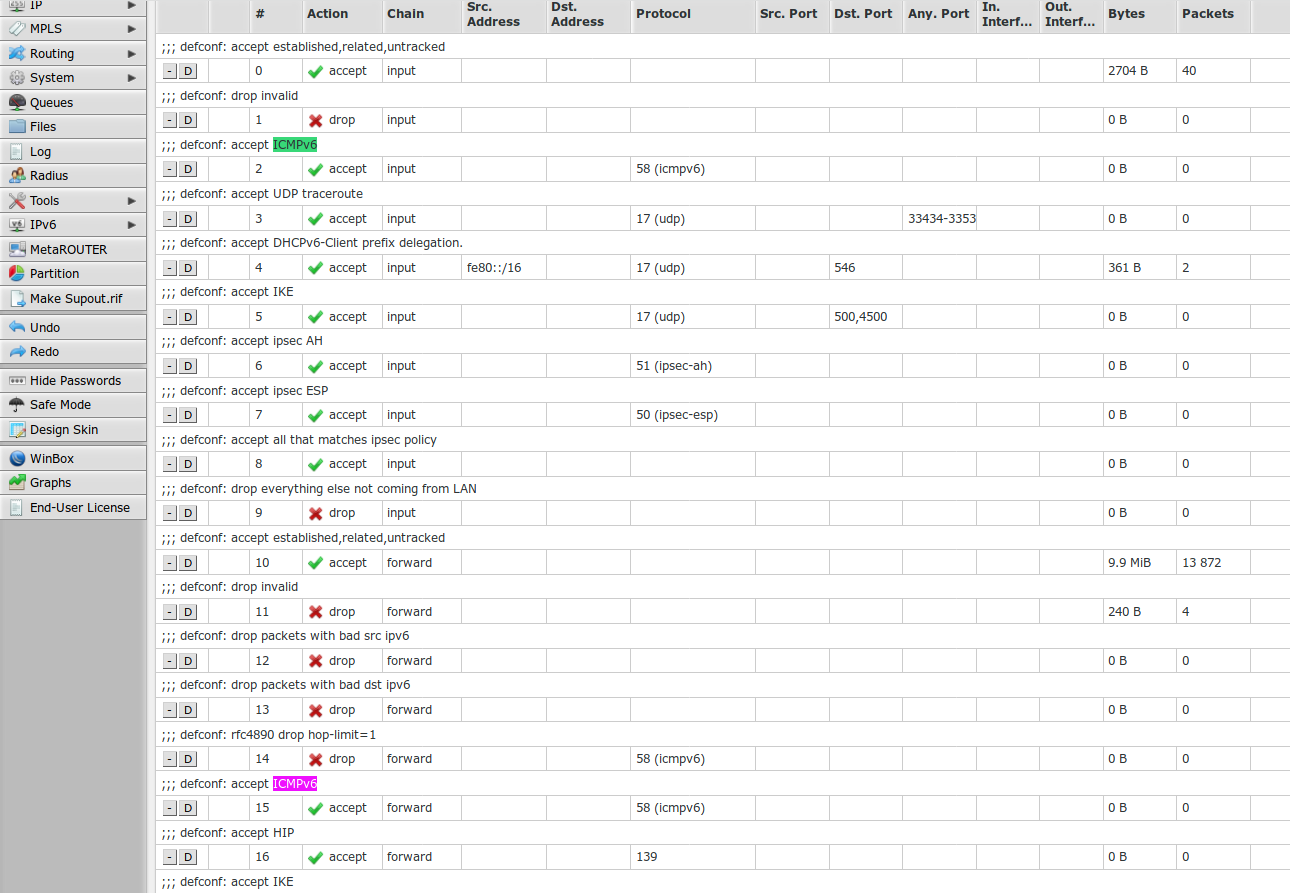

Does everything look normal here?
The defconf: rfc4890 drop hop-limit=1 rule isn’t possibly causing problems?
As far as other devices advertising themselves as routers, it’s a very small network, I’m sure there’s nothing like that on the network.
It looks fine, but it is hard to tell because you keep sending screenshots instead of config dumps, and not all fields are shown on the screen by default. It is better to post config dumps instead of screen snapshots, they have more info and take up less space.
