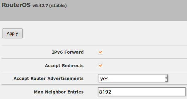

Other than “Accept Router Advertisements” need to be set to “no” or to “yes, if forwarding disabled” everything else looks fine.
Thanks for the reply. I tried changing that, and it doesn’t seem to make any difference.

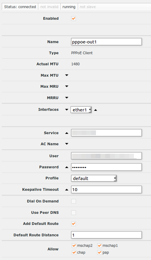

If pings work in both directions then generally there should be no MTU issue because path MTU discovery should work, unless there is a misconfiguration somewhere. Can you share your PPPoE interface settings? Obscure the user/password.
I occasionally see issues with MTU negotiation between PPPoE client and server, where they have a different understanding of the MTU of the other and this results in silent drops for packets that are too big.
Sure, here you go:

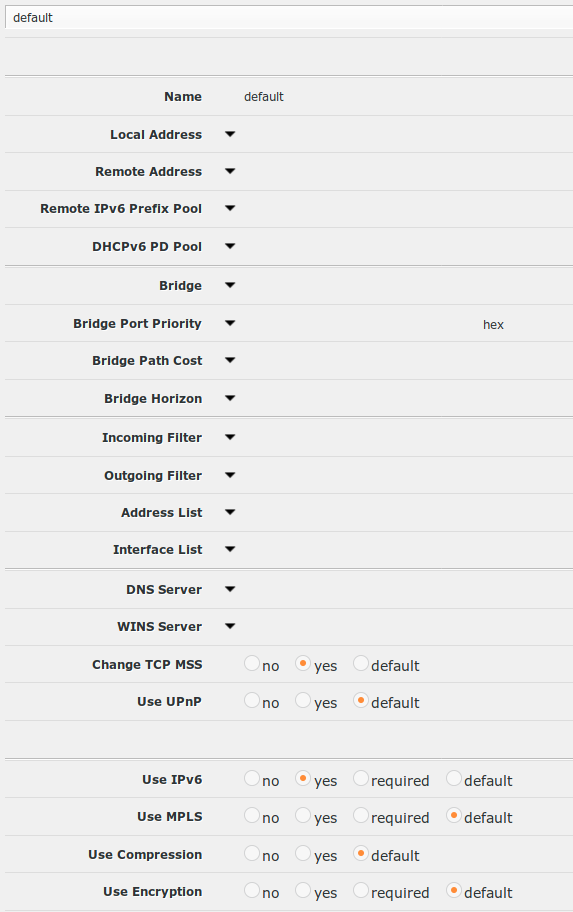

And here’s the default profile:
Try setting Max MTU and Max MRU both to 1492, and check the status tab for the PPPoE interface to see what MTU and MRU is being negotiated.
Done, the status shows it at 1492.
