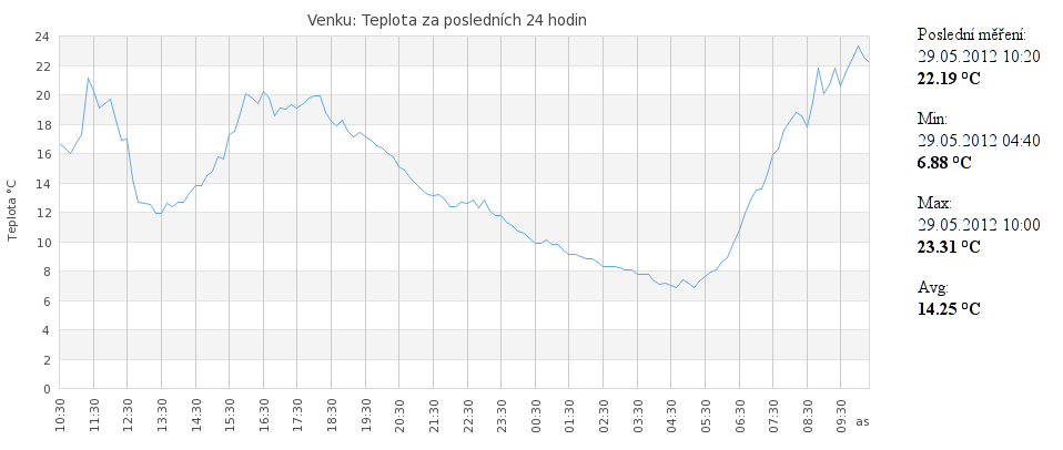

Hi Sergejs. Why Voltage is dependent on the outdoor temperature? RB800, ROS 5.7
It is bug or?

honzam,
Could you please clarify, where is the bug in your attachments?
/system health provides you with informational values about voltage/temperature, that can alarm you when something goes wrong with the specific board.
Sorry, my mistake. OID is wrong.
