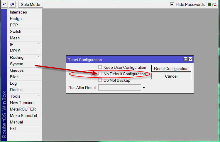

I was planning to start with a clean slate with an RB450G and version 5.24 and when I went to
System>Reset Configuration in winbox
… I checked the box that said “No Default Configuration”
and then clicked the “Reset Configuration” Button.
Now winbox will not detect the MAC address, and I can’t log back into the router using winbox.

Just for my own understanding, was putting a check in the “No Default Configuration” a bad thing? I am guessing that it “Blanked” everything including the Routers Ether 1 IP and is why I can’t get back in.

Again, only difference that I faced was, I think, ( . . . and I am only guessing here and maybe someone can clarify for those who may run into the same problem) by selecting the “No Default Configuration” option while resetting the routers configuration that it blanked the IP for Ether1’s port. I would have thought that logging in using a MAC address would not have mattered, but if you have to set your computer to be on the same subnet as the router and the router doesn’t have one set for Ether1 . . . well then you are screwed like I was.

Configuration Reset
Command name: /system reset-configuration
Description
The command clears all configuration of the router and sets it to the default including the login name and password (‘admin’ and no password), IP addresses and other configuration is erased, > interfaces will become disabled> . After the reset command router will reboot.
Command Description
keep-users: keeps router users and passwords
no-defaults: doesn’t load any default cofigurations, just clears everything
skip-backup: automatic backup is not created before reset, when yes is specified
run-after-reset: specify export file name to run after reset
Warning: If the router has been installed using netinstall and had a script specified as the initial configuration, the reset command executes this script after purging the configuration. To stop it doing so, you will have to reinstall the router.
